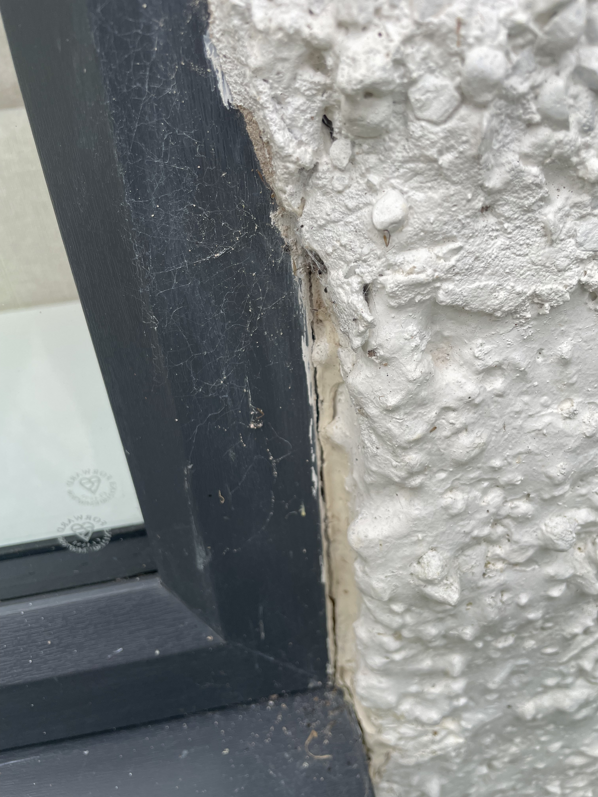

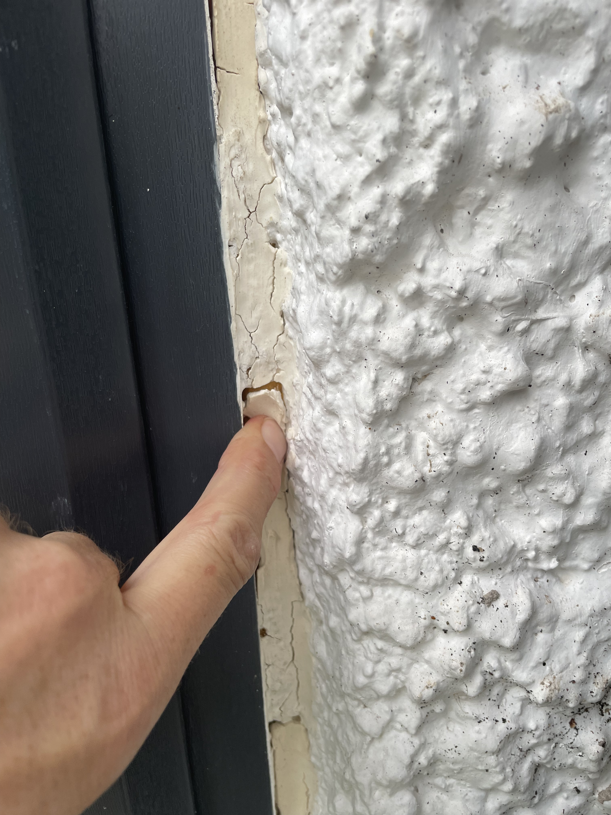

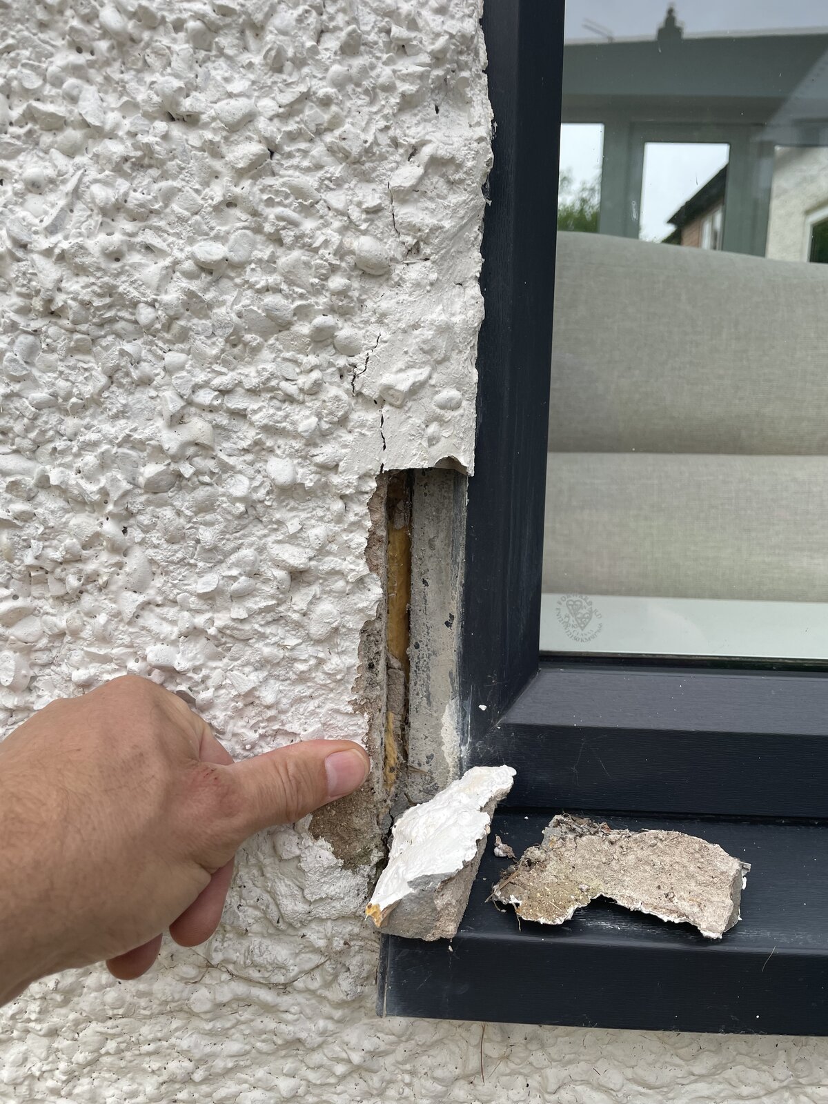

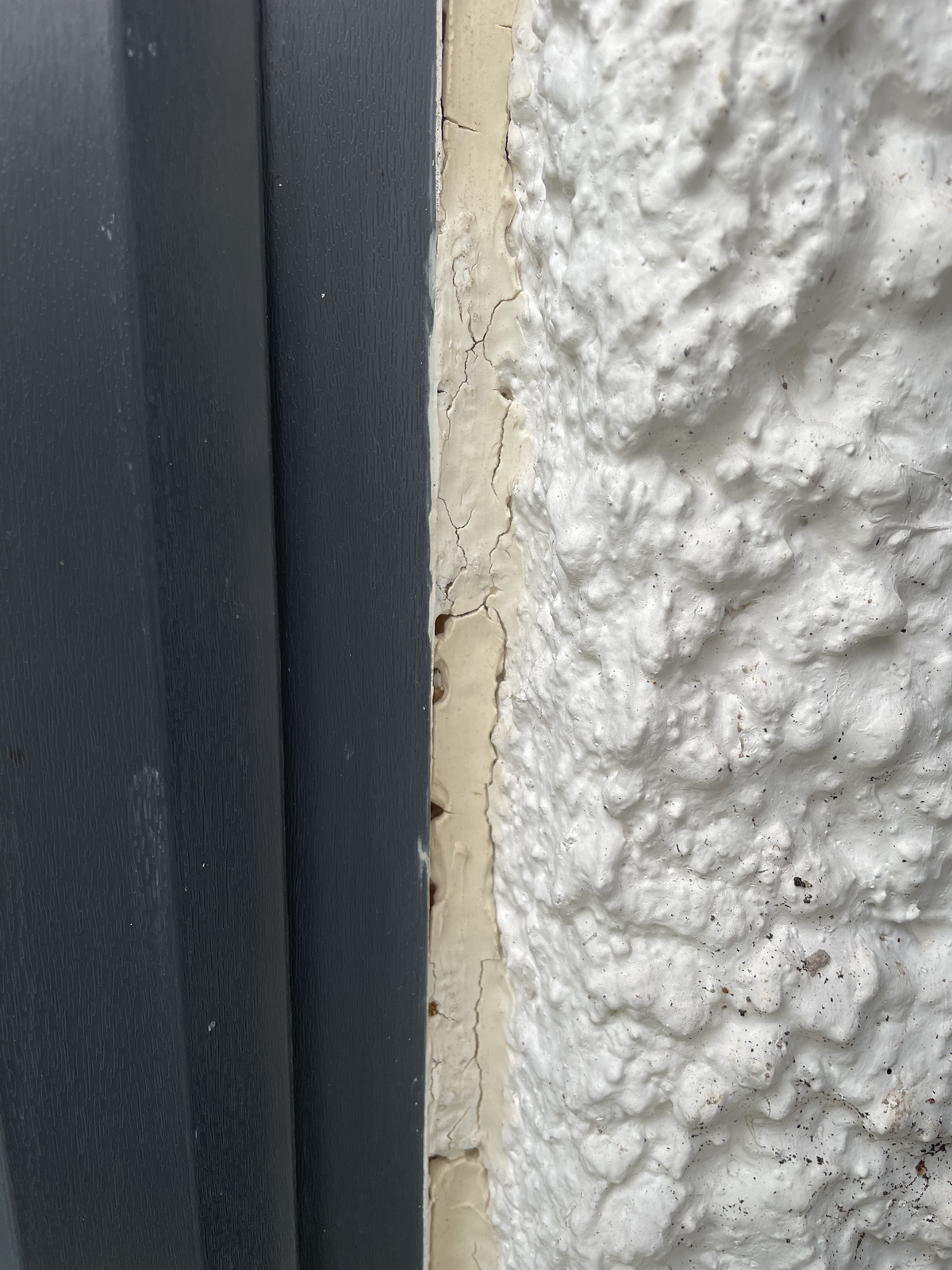

Hey guys. I'm struggling to find someone who can sort out a bunch of window reveals. Recently had a bodge job of an extension and the windows don't fit the openings properly. Pebbledash was put on around the windows when job was finished. A couple of years later the water has run down behind the render and its blown off above the sills (on multiple windows).
I don't mind having a go at resolving this myself but I'm not fully sure on best products or approach. I was thinking of building the render up to a wooden batten to form a reveal, then lining the return with UPVC. The reveal is about 5cm deep. Any advice much appreciated! Or if you are an experienced plasterer South Birmingham you could take a look at what needs doing. I want to get it sorted before winter as its getting damp inside.
Put a plastic corner edging up and render the side. Will square it off.
