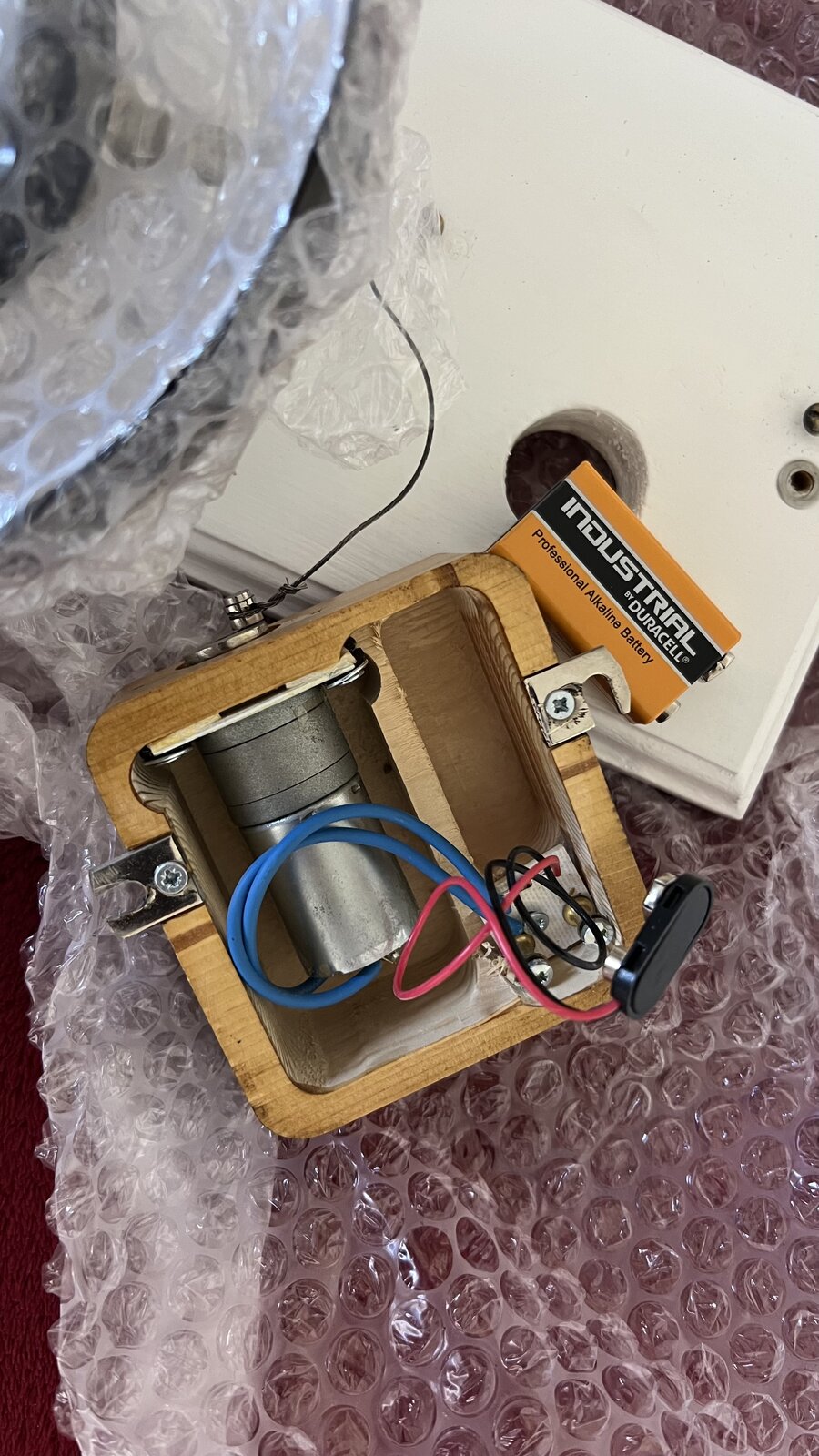

Hi
We have a battery powered ‘butler’s’ front door bell which uses a wired door bell press to complete the circuit. Is it at all possible to convert the bell push to a wireless one using I assume a relay to complete the circuit in the bell box. If so are any kits available?

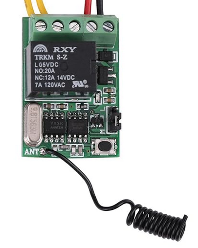

Not sure of a kit per-se, but I've seen a single Sonoff Wireless RF/WiFi Smart Switch paired with a wireless RF bellpush. The Smart Switch provides a 230V output that could be used to operate a 230V relay.
There are other versions of Sonoff that have voltage free contacts built in so wouldn't need a relay. I can't say for certain, but I would expect them to work with a RF switch as well.
I know my light switches can be worked with a push button and are battery powered, how ever it would stay on or off, not momentary, I am sure as @stem says there are Sonoff, or other relays which will work, this 1713437028537.png says
【Momentary Mode / Toggle】 Press the receiver learning button, the receiver LED will blink slowly, which means you will go into learning mode, press the transmitter button, the LED light the receiver flashes twice as fast, then slowly, that is, the learning is successful. Press the learn button again to turn off the light. It means that the learning is finished.
so seems likely will work. link to advert is here but I have never used one, and the add shows it being used with a key fob, so one would need to make it look like a door bell.
