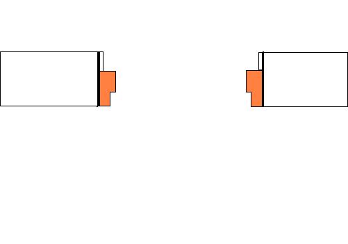

I'd use a standard door casing and fix it to one face of the stud wall. (not centrally in the 240mm space.
Like this...
The bit that's left can be plasterboarded over to return the other face to the casing (door casing in orange in the drawing) ;) ;)
Architrave can be fixed to one side of the door casing and something like quadrant to the other side.
ok. do you screw into the main section of the casing (the thicker part)?
Yes, but only to fix the casing onto the opening. The door hangs in the rebated part (thinner bit). The rebates are usually about 5/8"th thick. If space in the opening is at a premium, you could have the legs of the casing planed down a bit as at least a couple of the screws fixing the hinges would screw into the timber behind the casing.
PS don't forget to drill clearance holes in the casing when screwing the casing to the studwork. ;) ;)
