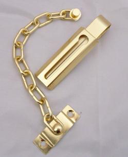

I have great doubts about door chains. Apart from in a Victorian house, I haven't seen one that looks like it would withstand a good boot or shoulder.
Even the better Chubb and Era ones (like this pic) only have two screws to hold the small frame part, and a kick on the door woulds tend to pull the screws out. The "door" part with the slotted bracket looks far stronger, as it has 4 screws and the chain is pulling sideways against them.
This ERA one says it is suitable for wooden or PVC, and it looks like it has threaded inserts for PVC.
I see that one also has the weakness of just two small screws for the frame part.

It does but the screws are size 8 and came complete with rawl plugs. We fitted ours to the wall rather than the frame and I dont think anyone could shift it.
The weakness is where the end of the chain bit is attached to the bracket that fixes to the frame, with a good shove I can assure you the chain can easily get ripped out of the bracket.
