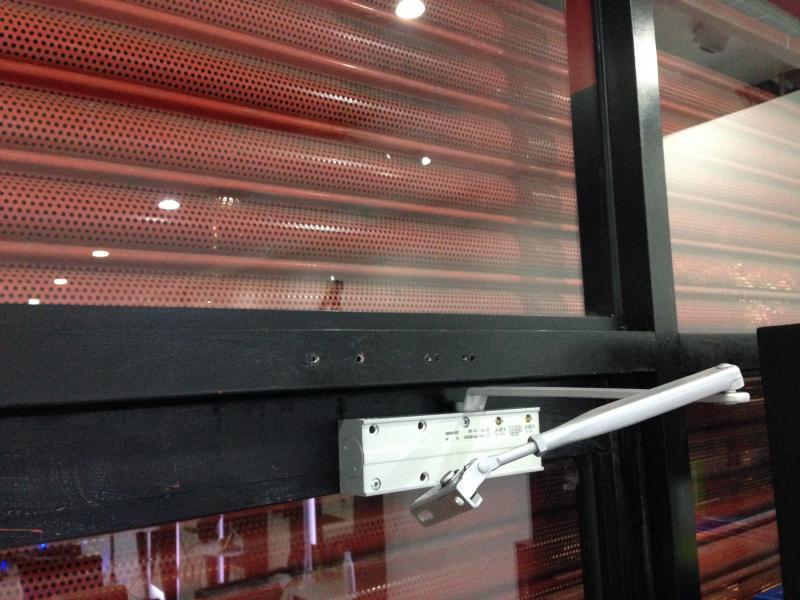

I need some advice on installing a door closer on a commercial metal door.
This is the door closer I bought from Screwfix:
http://www.screwfix.com/p/briton-1110-overhead-door-closer-silver/21234?_requestid=173580
Unfrotunately I can't get it to work, and I don't know if I'm doing something wrong or I have got the wrong door closer.

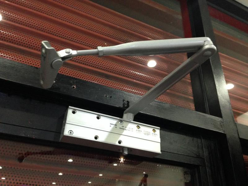

The main problem is that when I open the door the two arms of the closer kind hit each other thus stopping the closer from working and the door from opening.
I have attached some pictures of the door closer attached to the door.
Any advice would be greatly appreciated.
Assume you've used the paper template for fixing it to the frame?
Also i think the hydraulics need to be under tension so to speak, i believe what you have to do is fit the arm 180 degrees out and then turn it to face the door and fix
think you need a tramson plate,was 1 in the box?
it will be an l shape flat piece of metal with 3 fixing holes for the big screws and 2 smaller holes for the plate on the arm.
No unfortunately I have not, I originally left it up to my builder to do it thinking he knew what he was doing but I think the poor guy was not very familiar with door closers, he ended up saying this is not the correct type of closer for this door, mainly because of the distance between the door and the upper part of the door frame, do you think that could be the case?
Could you please explain the hydraulics bit?
There was a metal plate in the box, I had no idea what to do with it, how would resolve the problem?
there should also be some instructions in there aswel.
if not then try googling fitting door closures.
Looking at the frame I'd say that you will have to mount the closer on the transom - not enough space on the door itself.
Bearing in mind that if this is a fire door then you need to ensure compliance with any fire regs applicable to the building
Thanks everyone for your help.
I have now found the solution:
These kinds of doors have their own concealed closers and the one inside this door was broken so I called someone who came in and fixed it for around £180 which is not too bad.
