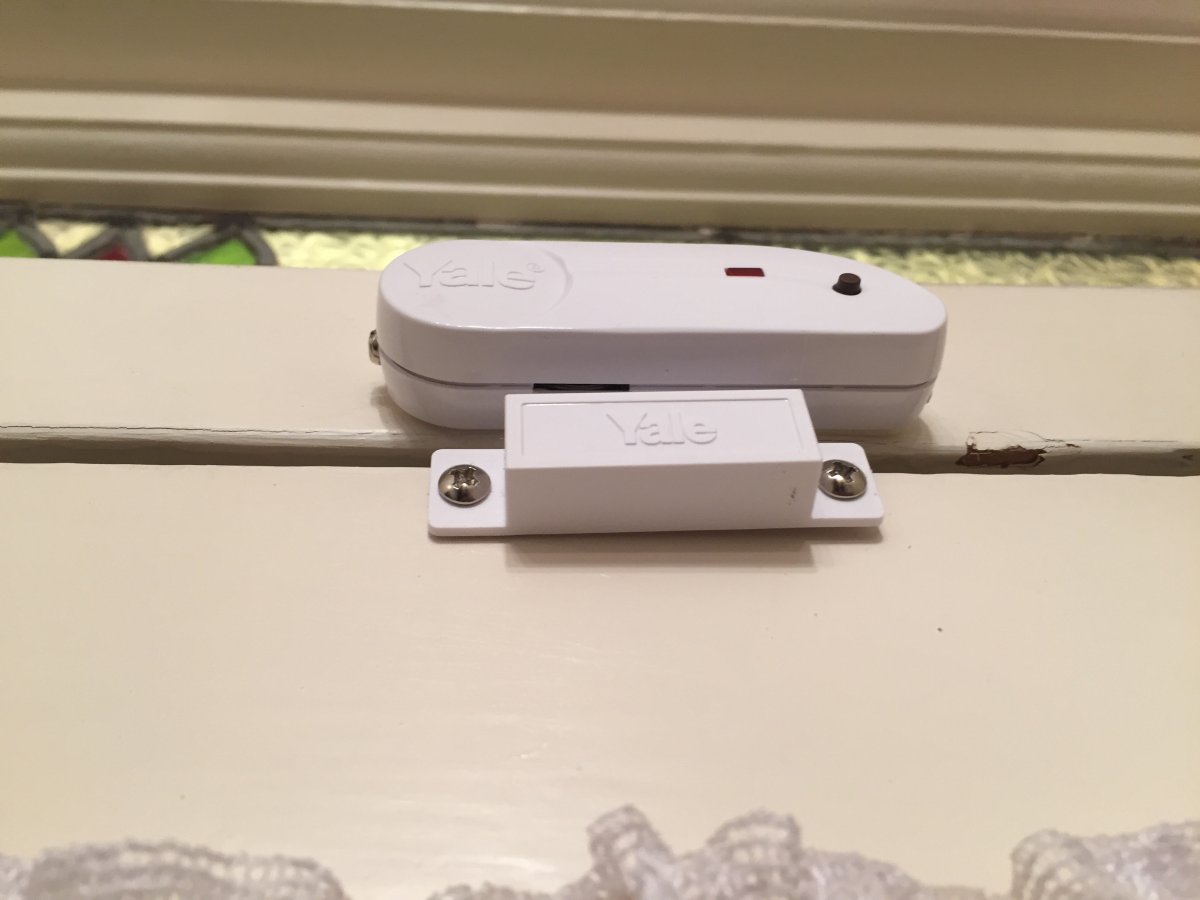

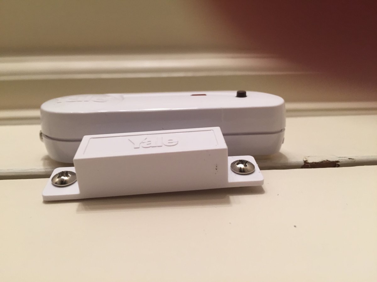

Hello,
Thank you in advance for any help on this, I've installed the HSA6400 but am having issues with the door contact on the front door ( only contact I've installed).
I keep on getting a Door contact tamper message on the control panel, just wondering if it's to do with the way the contact is fitted, I'm attaching photos.
Thks
Is the lid on properly? It doesn't look tight to me.
Compare the spring, which sticks out of the back and presses against the doorframe, with the other door sensor.

1/. In the digital images posted,the unit fixed to the frame appears not to be fixed flush to the frame, it appears to be slightly raised at one end?
2/. As a general question? does the door "Move" when there is a wind or gale blowing? can you move the door when close, that is if you hold the handle and move the door in and out can you detect a movement of the door?
Just some thoughts?
Thanks for your responses John and Ken.
Yes the lid doesn't seem to be on properly. I've given it another go ( and in the process slightly damaged the door). However seems to be on tighter. Pic attached.
And yes, when I move the handle I can sense the door moving.
I no longer receive the issue and hopefully will remain like this. Anything else you think I should be doing?
Thank you
