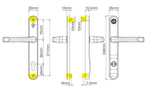

So, I've had a new handle arrive and it's exactly the same apart from the "lug" that goes into the door itself. Shall I just go ahead and make that part on the door wider? Any tips or suggestions? It looks like it's 10mm according to the diagram that the manufacturer provides. See attached as it'll hopefully make sense on there.
