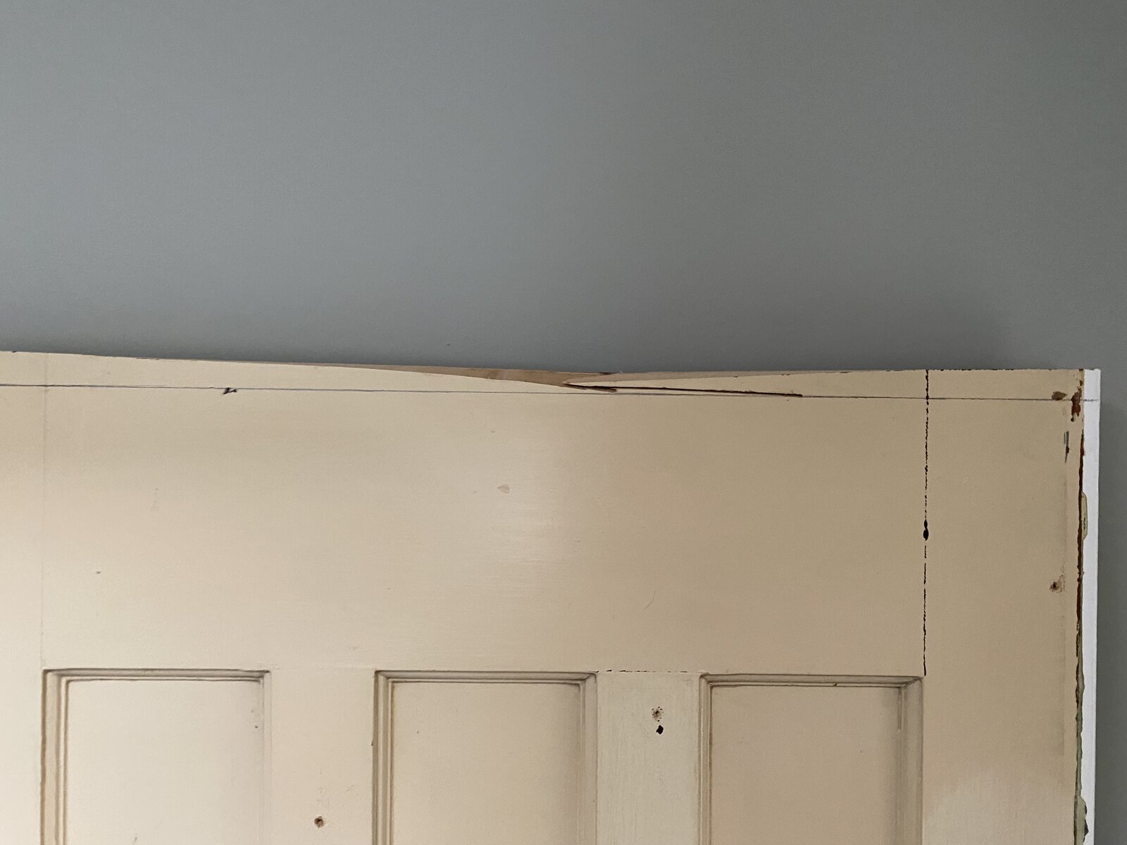

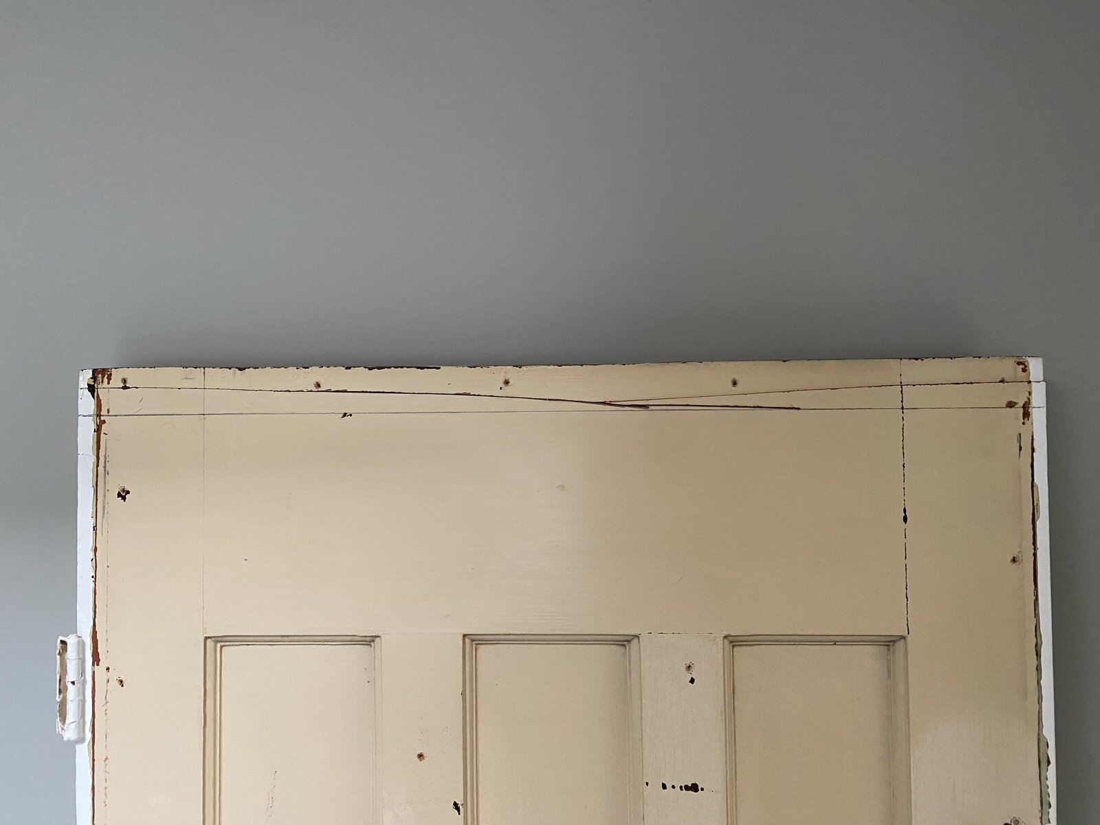

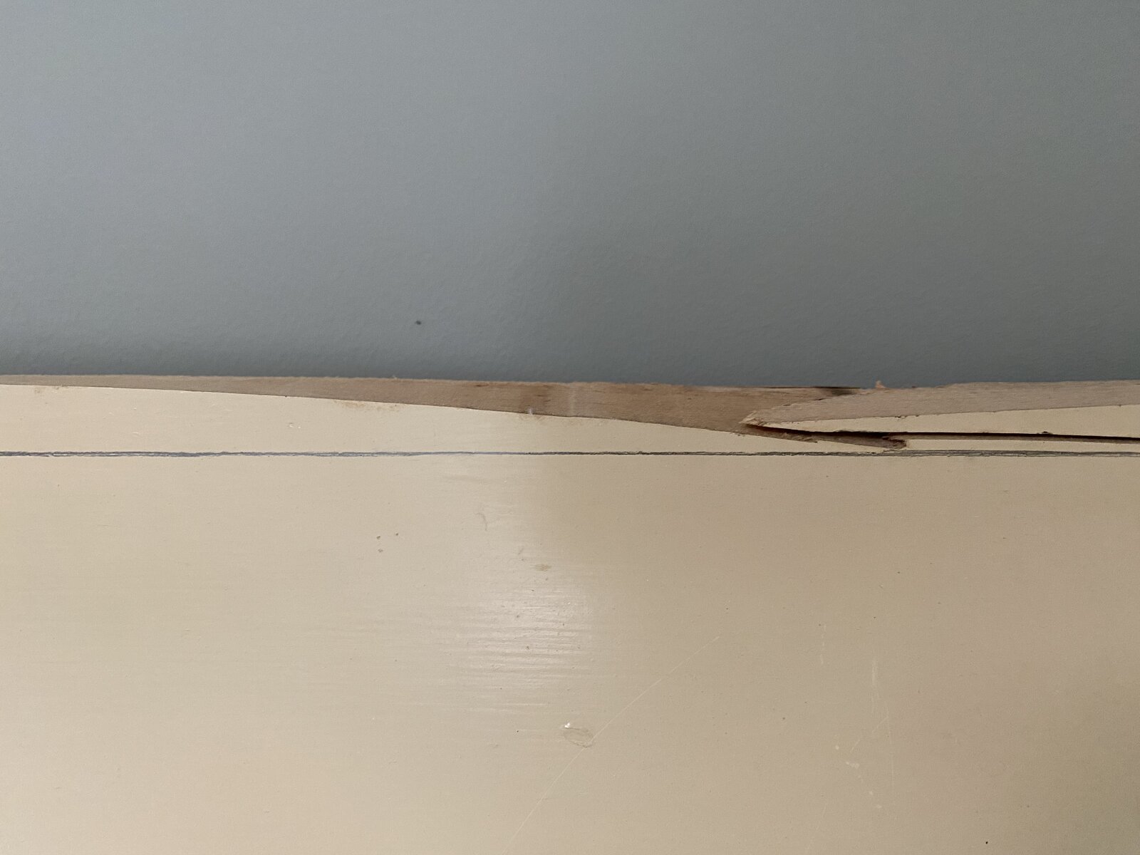

Rookie mistake! I need to trim the bottom off an old wooden internal door due to new carpets. I used a jigsaw with a guide clamped to the door and thought I’d done a great job until I realised the underside had veered inwards and taken a chunk out that I didn’t need! Lovely straight line on top though :)
I’ve realised I probably should have invested or borrowed a circular saw but moving forwards I can only see two options.
  1. Make good and cut new straight line at the deepest point but this could leave the door with a large gap.
  2. Glue and screw the cut off section back on and then, using a circular saw and guide, cut off the original intended bit again, leaving the unintended piece then still glued and screwed in. Then fill, sand etc.
I’m inclined towards option 2 but do you think glueing and screwing would hold this section in place while I cut through again with a circular saw and would a circular saw go through the screws ok?
I know a new door would probably be easier but they are the original 1930’s doors we are trying to restore. Any ideas welcome

You could cut off what you need to to make the bottom square again and then glue a piece of strip wood the required thickness?

Ideally you would use epoxy resin to glue the section back on. They are not cheap though, and you may need to to buy a dedicated skeleton gun to dispense it.
I recently had to extend the height of a new door. I used pva glue and wooden dowels. I did use screws to pull it together and then removed them once the glue had cured.

Glue it back up and screw for temporary clamping, remove them before you cut, (save your blade) you can always screw back in once you've made your change.
Clamp a straight edge to your door so you can slide the circular saw along it.
If using a cordless, adjust the depth and cut the door in say 3 passes, making the blade depth gauge deeper each time.
Hopefully you won't need to plane it, just sand.

I strongly advise against leaving screws in doors. If someone comes along later to trim the door, at best, their planer blades will shatter. It may however result in injury.
