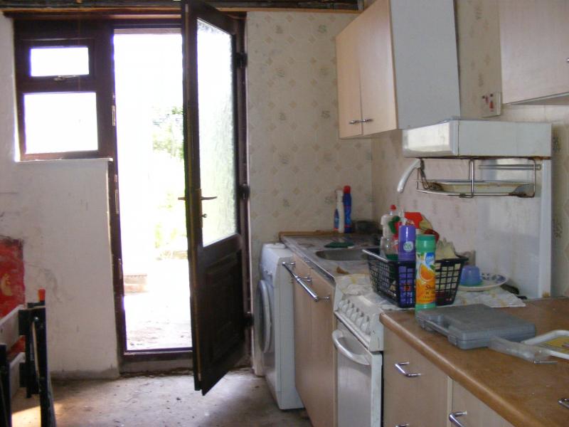

I would be grateful for any advice. I would like to replace a kitchen door and window with french doors (4ft x 7ft) and a lintel. The survey says (i have just bought the house) that the current window and door need a new steel lintel whatever is there is not adequate. My builder says i do not need to involve building regs as we would be improving the current situation. He says a concrete lintel would suffice. Is this right or should i get in building regs before we start. Also do stud walls need building regs for removal. I have uploaded a couple of images for more clarity. Thank you

I have contacted building control and they have said that the removal and replacement of the lintel will require building regs approval - so i guess i have heard it straight from the horses mouth!!
That's rubbish - the horse wants shooting
Thousands of these lintels are replaced routinely by builders ... and by the Local Authorities themselves in their refurb schemes ..... along with other "structural" joists, beams and roofs etc, and none of these have ever required an application.
Replacement is maintenance. It only may become controlled work if there is alteration or addition
It's all about what's considered minor works & something more significant; replacing a structural lintel is significant IMO &, at the very least, requires consultation. They want to take a look & why not, with so many cowboys around who can blame them; it’s no big deal!

A replacement lintel, just like a replacement brick, a replacement joist and a replacement rafter is maintenance, it is repairing what was there, it is replacing an item with a similar item supporting the same loads
It is only when we get into the realms of altering - of altering loads, of altering components' ability to support and spread loads, or of significant replacement - whole sections of walls, floors, roofs, that the Building Act comes into play.
There are various things explicitly specified in the b/regs which are controlled, but lintels are not one of them. If that's not the case point it out to me.
