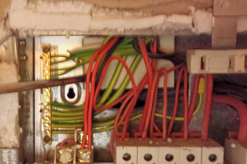

I am new to the group but need some help.
I have a mains powered doorbell and the transformer appears to have become faulty.

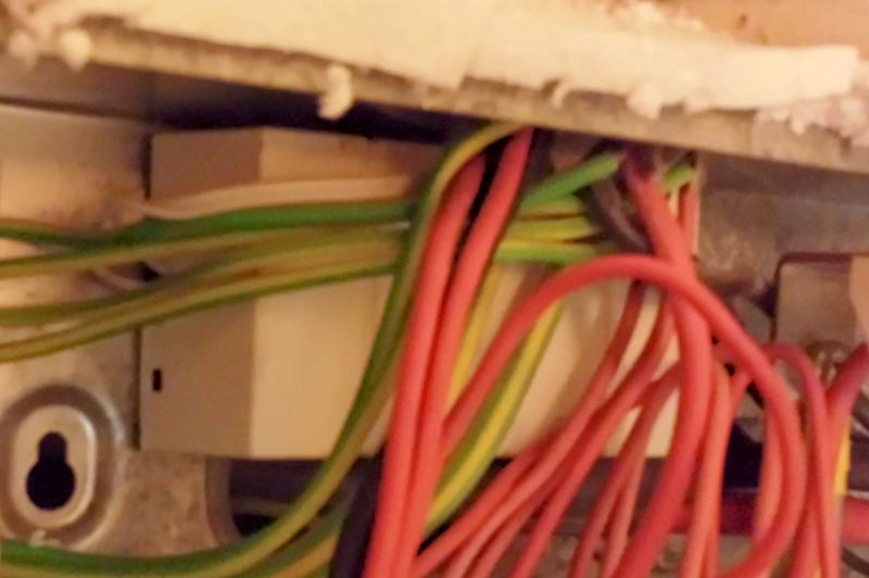

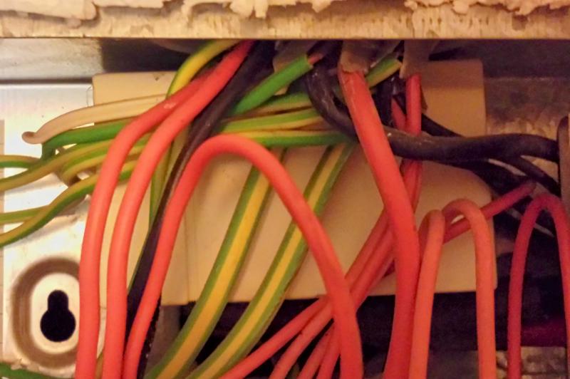

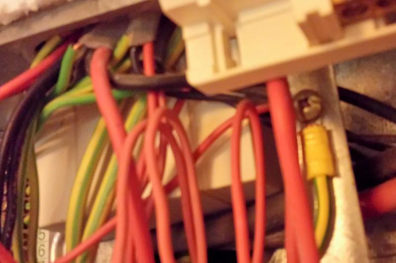

I have located the transformer but it is at the back of the fuse box (I hope to attach some pictures)
If someone can give me an idea on how to remove the transformer from the fuse box as it seems to be attached in someway to the back of the of the fuse box and I can not see a way to get the cover off let alone get to the transformer.
I have turned off the power before going into the box, so just need some help in getting the transformer out of the box.
Thanks in advance

It's not supposed to be there, so who knows how it's been fixed. Might just be wedged in.
2 options:
1) Disconnect all the cables in front of it and move them out of the way so you can see what's going on, and hopefully you'll see how it's fixed.
2) Leave it there - you'll not be installing the replacement where it is.
BTW -
- there's no point trying to get to the internals of it - you can't replace them.
Thanks for your replies and help.
I did think that it should not be there but this house was built by subcontractors who bid for the work............back in the day.
I will do what has been suggested, this was down the same line as I was thinking and leave the old unit in situ and fit another unit.
As I don't know the VA for the transformer (the ringer is 8 V) so I would assume that the Transformer will be 8v 1 amp but if I get a variable unit I can cover my basis and start low and work up.
Thanks for the 2nd opinion as this is just what I wanted to hear
