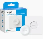

So type of bell matters. I know my door push is not rated for outside use, 1727717520980.png it was never bought as a door bell, it was got to switch lights on/off from in bed, but we used voice commands, so found another use for it. Now been outside a year with no problem, but last house the proper door bell push, had to be replaced many times. Just this house door is in sheltered position.
