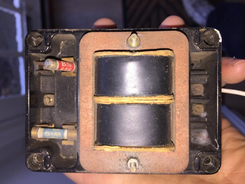

Hi, a picture of the transformer would be good, just incase it's very old or damaged and unsafe.

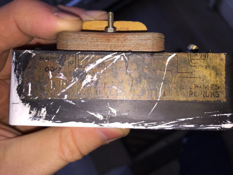

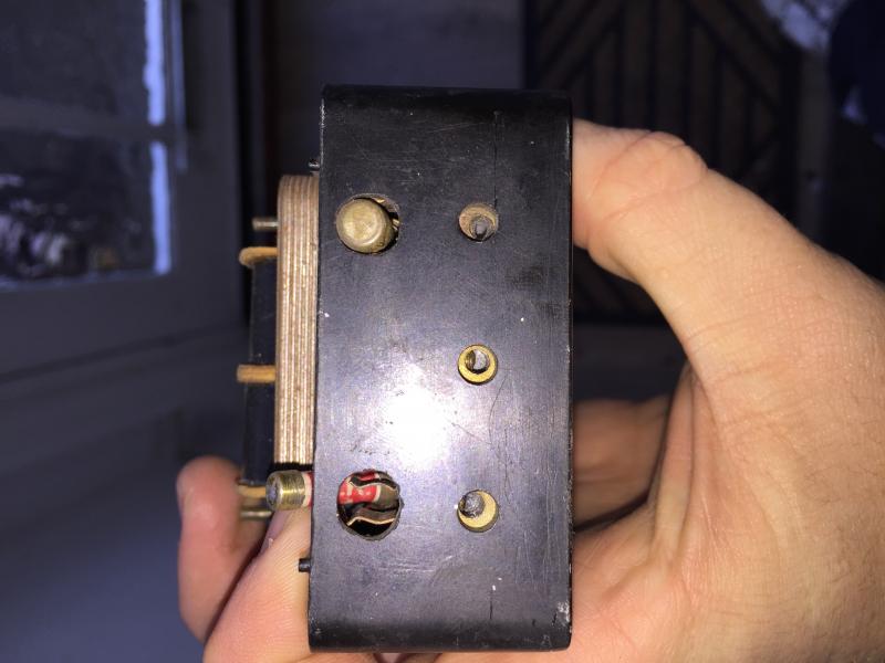

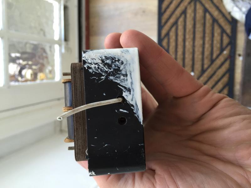

That's a museum piece and should really be allowed to retire gracefully into someone's much-loved collection of electrical bric-a-brac.
Double pole fusing hasn't been used for about 70 years.
No strain relief on incoming live cable. No provision for outer sheath of cable to be protected into the enclosure. It looks like the enclosure has been drilled at the fuse ends which will make it not touch safe. Is there actually a top half to the enclosure?
It can easily be replaced with a modern bell transformer of appropriate voltage and wattage. The bell can be re-used as it is isolated from the mains by the transformer.
So basically I need a modern transducer and the bell should work fine? Sorry this is all new to me. And yeh it's a little on the old side, the wire that was being used just snapped when I tried to bend them to reach the fastening screws.
