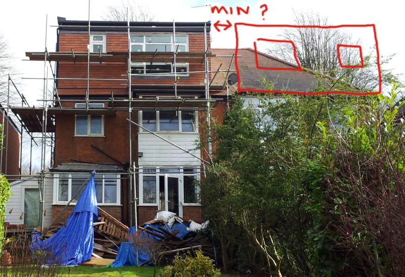

Ive done a loft conversion with the dormer the full width of the house (see picture) (the dormer cheek is tiled as well. )
my neighbor wants to do something similar and wants it to be the full width as well.
i don't want her to butt her dormer cheek up to mine as i think there is no room to service the dormer cheek if a tile breaks etc.
is there a minimum distance see must keep away from the dormer cheek.?

She can build up to the boundary, and even raise your half of the party wall if she likes
There's an advantage to you if the neighbour does build up to yours. If they simply link up with your roof and front wall, then you lose an external wall and so reduce the heat losses and maintenance requirements.

if she builds on my side of party wall she will disturb the tiles on my side and the soakers under them. can she do this. the dormer cheek is right on the edge of my side of the party wall
also isn't there a minimum gap required as if there was a problem like cracked tiles , leak how would you be able to service and repair them if there is no gap there.

Simply put they can and TBH there is nothing you can do to stop it as you have carried out the same yourself
No Minimum gap either

Back to the question, there is no minimum gap. You are actually better off if the neighbour builds up against the dormer cheek and seals across it

Can I ask why the windows are so big that the lead flashing goes over them rather than a course of tile above them and then the lead flashing :?: :?:

The neighbour can knock the tiles off and build right up to the new wall - problem solved, no tiles to fix!
