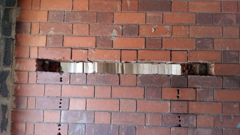

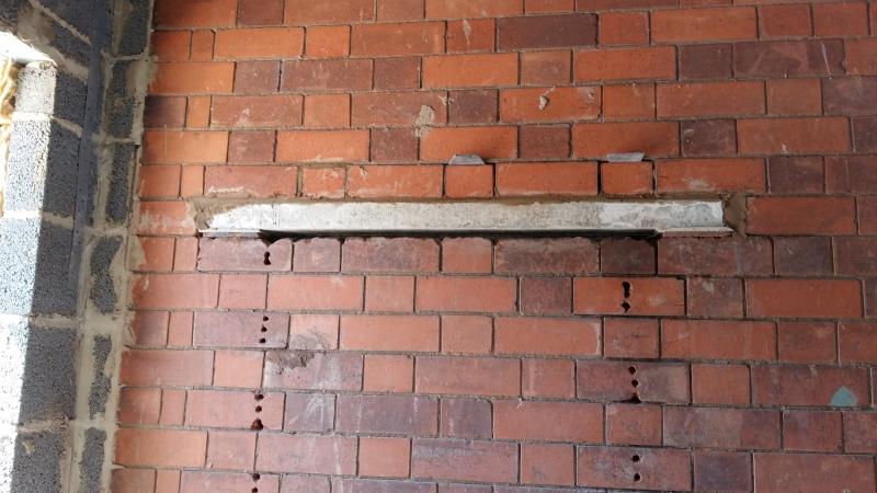

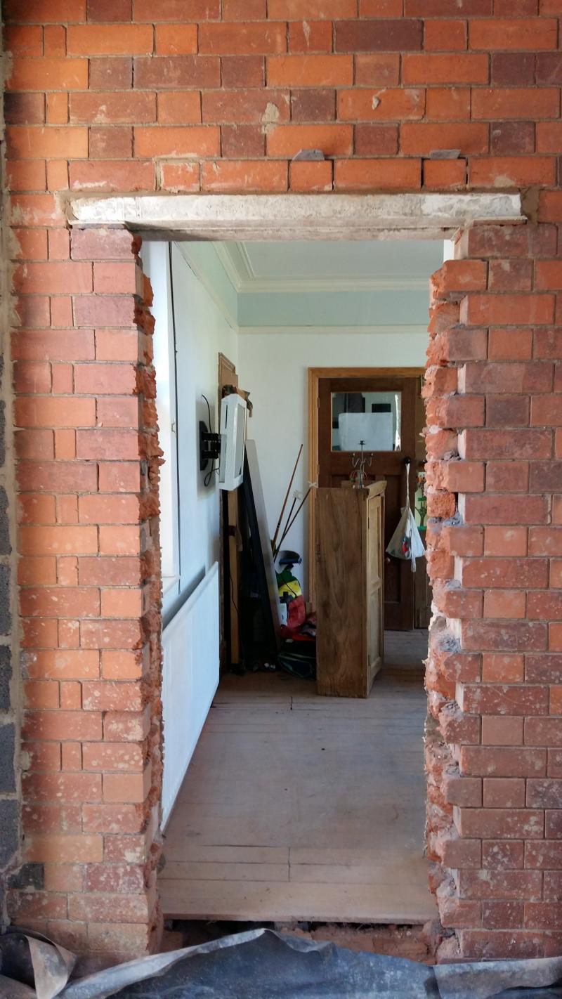

You've said that the doorway is leading to an outhouse, so the implication is that it'll end up being an internal doorway rather than external, so in many ways, a treated wooden lintel would be okay, but I'd rather go for the concrete ones instead. You don't need a padstone or engineering bricks on that width though. You could get away with 4" on either side, but 6" support is more sensible. Get a pair of 1.2m lintels, and cut them down to 1.05m with a stone blade in an angle grinder - stone blades go through metal as well. Cut a section out of the mortar course about 3 courses above your opening, and use a strong boy on an acro supported on a short scaffold board. Use a mortar rake or angle grinder to get the bricks out carefully rather than using a hammer, and take out enough bricks to get the lintels in, and then bed them in with the 3 in 1 mix, but remember to push the lintel to top of the bricks rather than the bottom, as it's 10mm thinner than a standard brick - easier to pack either side up by 10mm rather than do a thick course of mortar above the lintel. Then reinstate any dropped bricks above the lintel and use a few bits of slate to pack out any loose bits. Then leave it a day or two to go off before you take out the door opening.

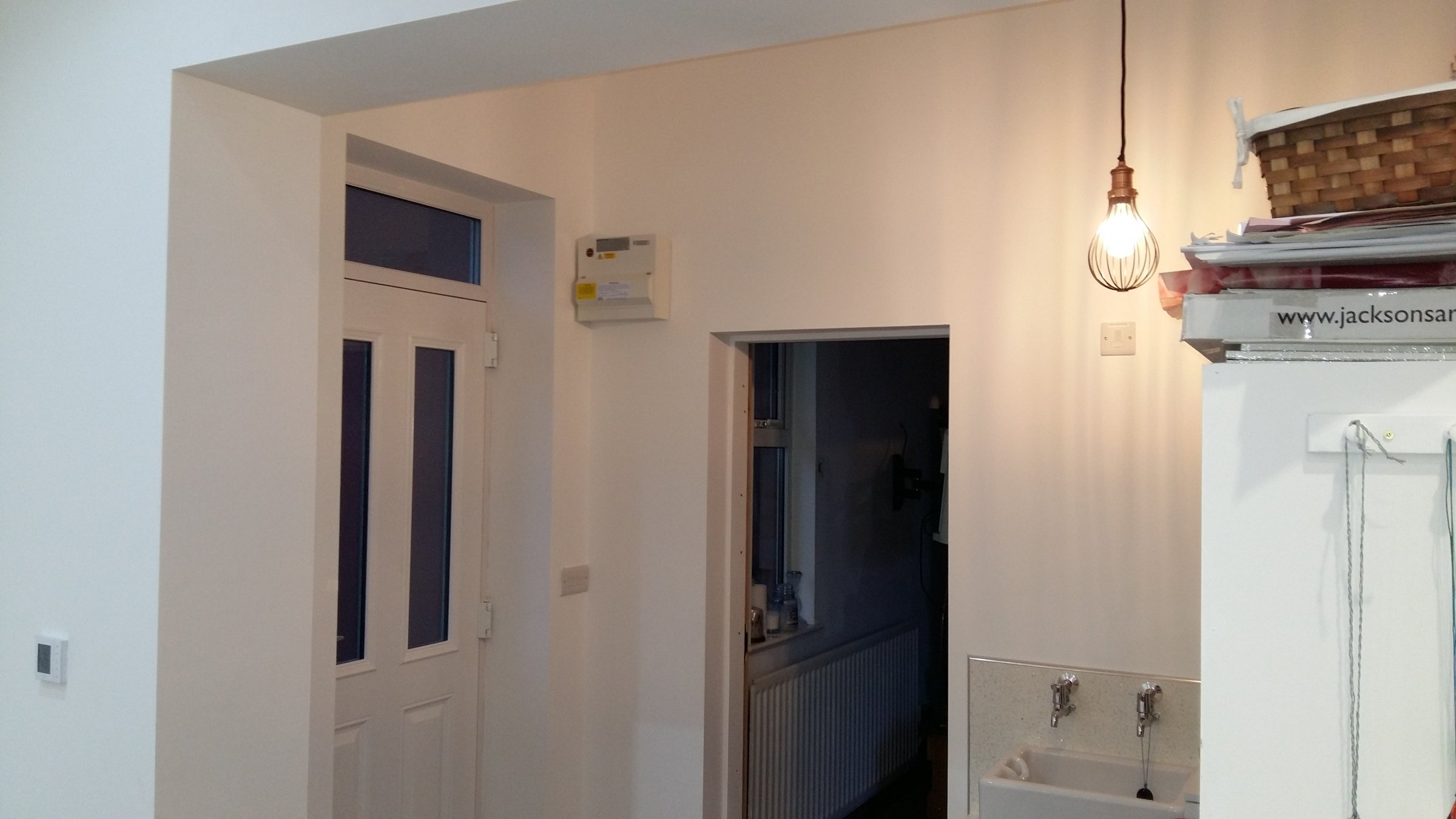

Nice job, well done. So why post the thread when it's already been done.
Looks like i'm worrying about nothing. It all looks easily doable. Thanks for the pics noseall.:)
