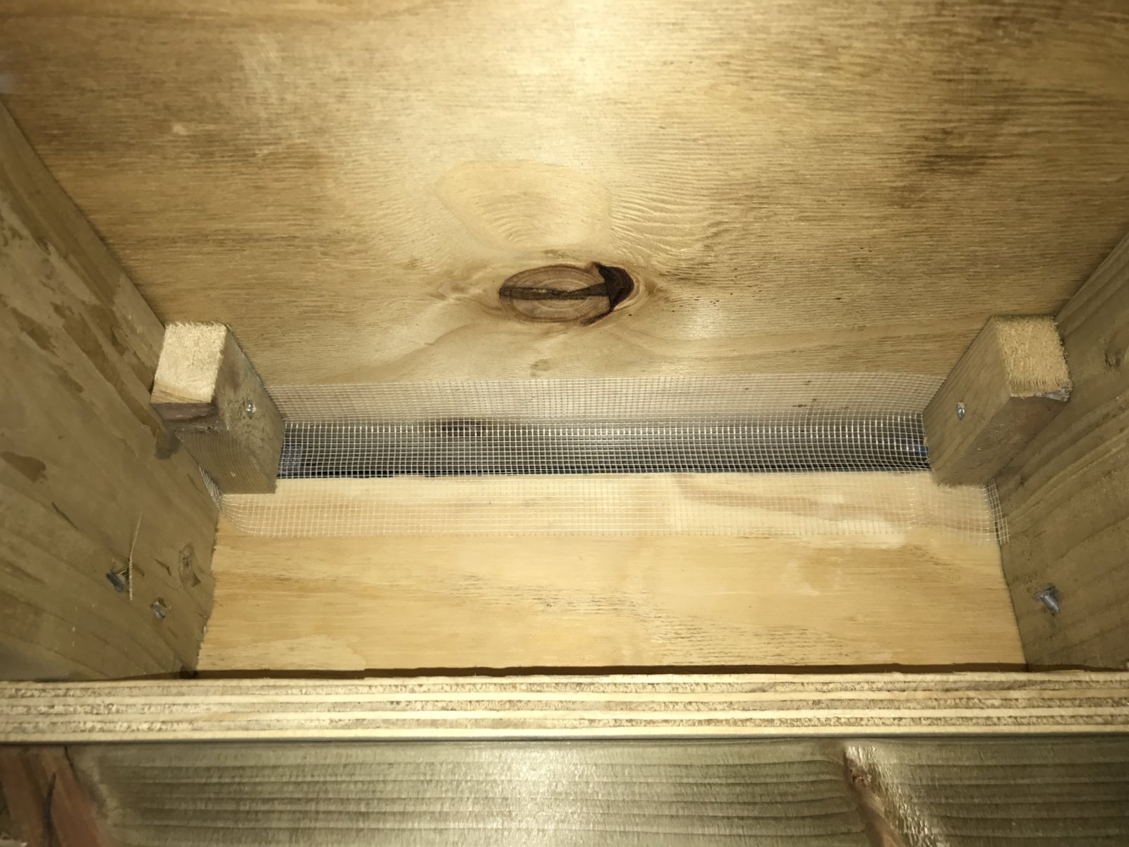

On mine which is similar I have the rubber on ply/osb, that’s on top of the joists.
Between the joists top to bottom I have 50mm air gap, 125mm Kingspan, then under the joists a full layer of 50mm Kingspan then plasterboard. The air gap has a mesh to stop wasps.
Temperature wise it’s great, sound wise it’s ****e.
