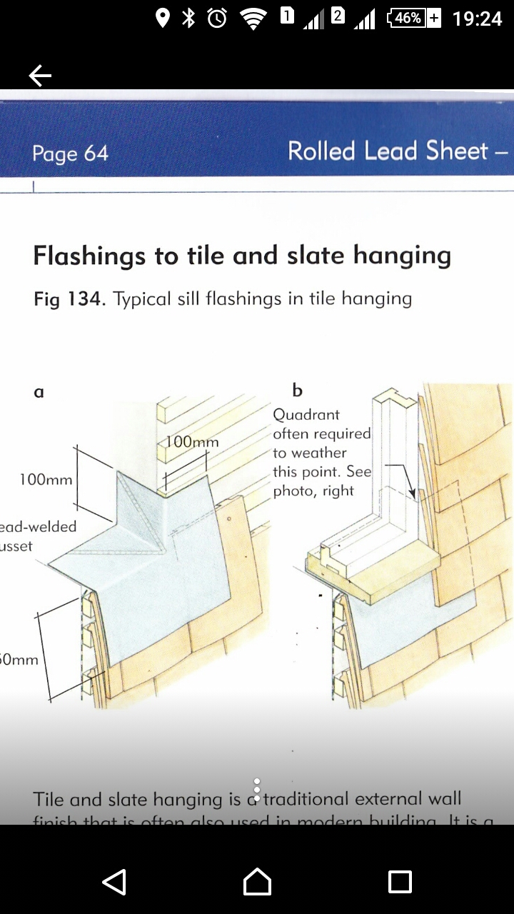

you should have had lead apron installed when your tiles reached the cill before you carried on up
Yes i was planning to do that but as i was still unsure of what to do i figured i could retro fit and slide in after as it was a better use of my time than scratching my chin pondering. :)
yeah you can but it should have been a welded tray
like this

Yes that was what i was asking in the post if i needed one. Where were you when i asked :) Anyway i decided to buy gussets and slide in. (still need to do that bit but have them ready) it was visual detail i was after as most examples are finished and wimdows in place. Got hold of an image from lead association manual in end. still not sure about soakers usage up the verge as i think they willl need painting. what would you do?

Thanks for pic and explanation. the sill i have is even shorter than your picture but i can return around slightly so the architrave ill buy will sit on it.
Got this that shows what ypu have explained.
