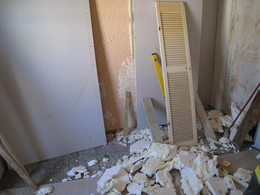

This ****ed up majorly.
I spent yesterday boarding the chimney and alcove and this morning came to find all the foam behind had pushed the board from the wall.
First time this has happened to me as relying on the strength of the foam alone to fill a 30mm void behind, and it's totally failed me.
I don't think even conventional plasterboard adhesive would have done the job because of the void.
Wanted to avoid battening out the wall behind but looks like it's back to square one now.
Waste of about £50 materials and an entire days work down the toilet. All the polystrene has lifted from the board so two sheets scrapped
What type of foam did you use? Did you use the correct low expansion adhesive, like Dow Insta Stik? I've used loads of cans of the stuff without any issues, including on voids greater than 30mm. It stops expanding after around two minutes and can be cut after around ten so you can be confident that it has set after lightly holding it. If your foam was still expanding after that then either you used the wrong type of foam or maybe something in the can had gone off. I haven't used drywall adhesive for years.
What did you do to prep the boards and the wall behind? It needs a good, solid background which should be misted with water immediately before applying.
Dave I used this stuff http://www.toolstation.com/shop/Adh...ing Foam/Dry Wall Foam Fix/d180/sd2857/p60449
Don't get me wrong the foam is fine.
What I tried to do was lap the front boards you see in the picture with the ones on the side (in the alcove). So at no point was the board actually in direct contact with the wall besides that batten running through the middle, because the alcove boards stick out to much.
I left the job in a huff, and instead fitted two window soffit boards and the reveals, however I struggle with getting the boards plumb with foam adhesive.. do you have any useful tricks?
That looks like the right stuff, although I've not used that specific brand before I expect they all work very similarly. It shouldn't have expanded very much though (maybe 20-30%) - if it managed to push the boards off of the wall then maybe that brand can't be used to fill voids in one go. You may need to build it up in layers until you can fix in one go.

Ok well I've done the whole room now.
The mistake I made was not to properly support the boards, that's why the first two I did literally just pulled off the wall - the foam didn't push them I now realize.
For anyone that says foam fixing is a bodge, well it's absolutely solid by touch, and I've checked to make sure there are no flimsy areas. As already said I wouldn't dream of foam fixing a ceiling but for walls it works perfectly well. I really hate mixing drywall adhesive in a bucket, I just avoid it where at all possible
