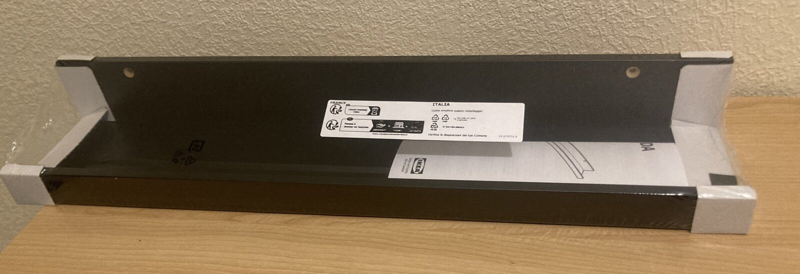

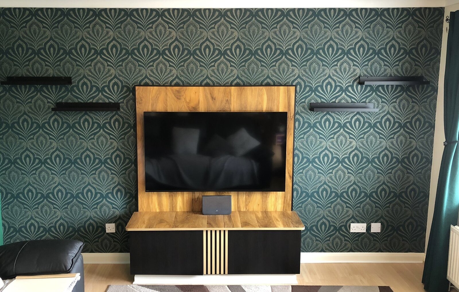

I've only ever used normal rawl plugs for fastening any thing to walls but on this occasion at my son's more modern house it would entail identifying the gas pipe and cable locations then using maybe 2" screws into the breeze block which seems over the top for 4 shelves that will only have small light items on them.
I'm wondering what modern fixing versions might do it?
Mastic - Mastic and a pin or two - Double sided tape .....

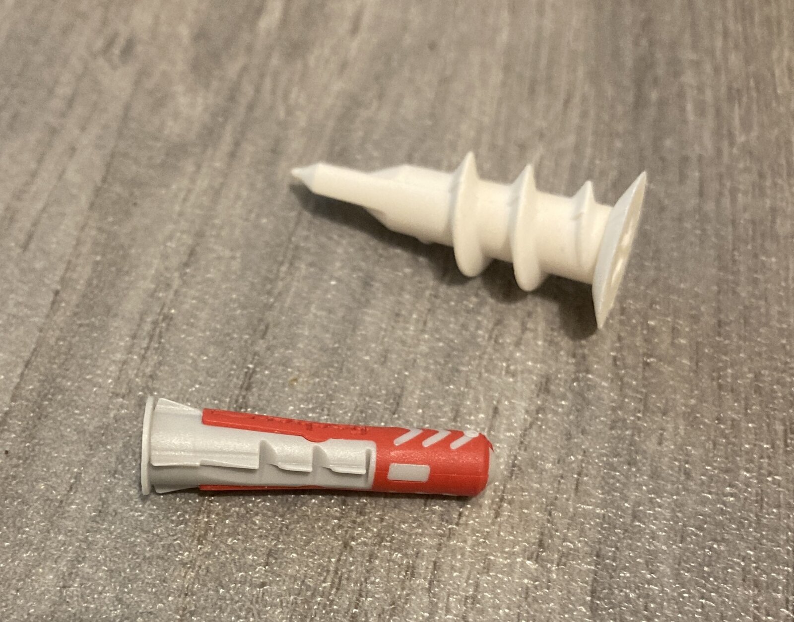

If you drill into a dab then any suitable plug works. If you are only in the plasterboard it's choose a suitable plasterboard plug. Or go longer and into the blocks with 50mm plugs and suitably longer screws... The cost difference will be minimal and provide a far superior fixing.
I've used Fischer universal UX6 and UX8s to fit items to dot dab and stud partition walls... Their Duopower plugs also look interesting and do a similar thing.

I looks as though I'll have to do the job properly then :giggle:
I think I was hoping for something dead easy, rather than starting over again with the cable sensor and drilling thro into the blocks.

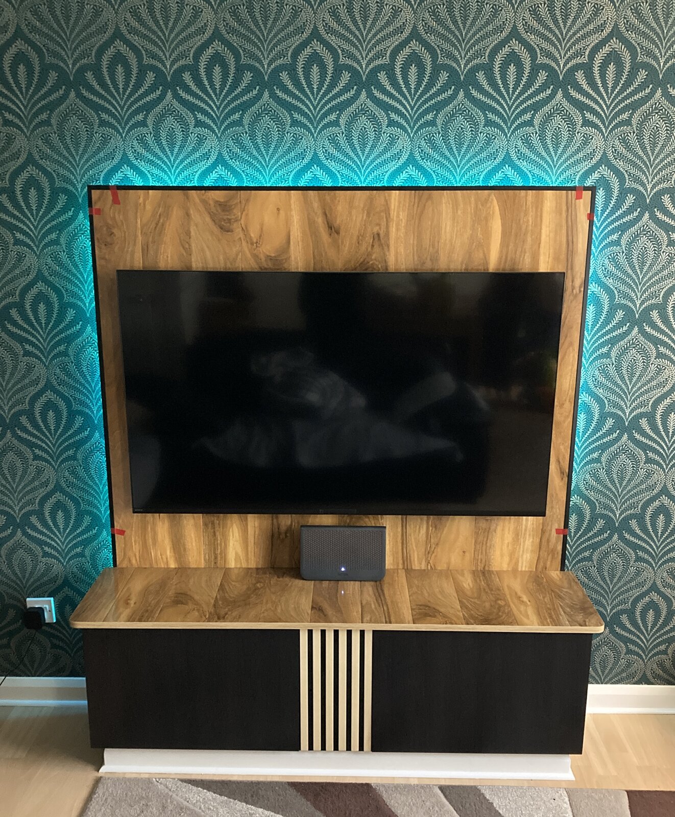

The TV cabinet and back board were made from scratch and there's only fours screws holding it back to the wall ... there'll be more drilling fitting four tiny shelves!
