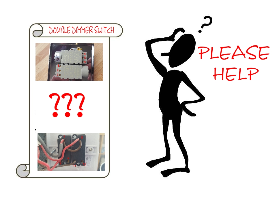

I am trying to wire a double dimmer and have no clue as to where the wires go, can the forum please help.
I have tried to make the solution as simple as possible.
can some pair up the numbers from old switch to new switch please, see images, also where do I run the loop to on the new switch

Not sure you can! The wave form with a arrow though it often means it is designed to work with another switch as a two way with slave and master. My first action would be to read the instructions that came with the new switch. Until I am certain about what if anything goes into the wave form with arrow terminal I would not try fitting it.

Wavy line with arrow through it is the same as 7 & 8.
9 & 11 go into L1, 1 wire in each.
Before you do anything , are the earth wires, the new switch has a metal front and there foe MUST be earthed. If there is no effective earth wire(s) then you cannon fit a metal froneted switch / dimmer
7 and 8 are the Live feed to the two switches and the Live feed onto other switches.
9 and 11 are the switched Lives to the lamps.
Note which wire goes to whch teminal before disconnecting them

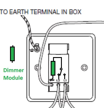

If the new switches follow convention then 1 and 6 connect to one side of the dimmer module. The other side of the dimmer module 1 goes to either 2 or 3 depending on the switch and the other side of dimmer module 6 goes to either 4 or 5 depending on the switch.
So replace 7 with 1 and replace 8 with 6
Replace 9 with 2 and replace 11 with 4
If the switches are upside down then use 3 instead of 2 and/or use 5 instead of 4.
It does not. On the Schneider dimmers the wave/arrow is the same as the COM terminal. Also you can use these dimmers in a 2-way circuit with a standard switch at the other end.
