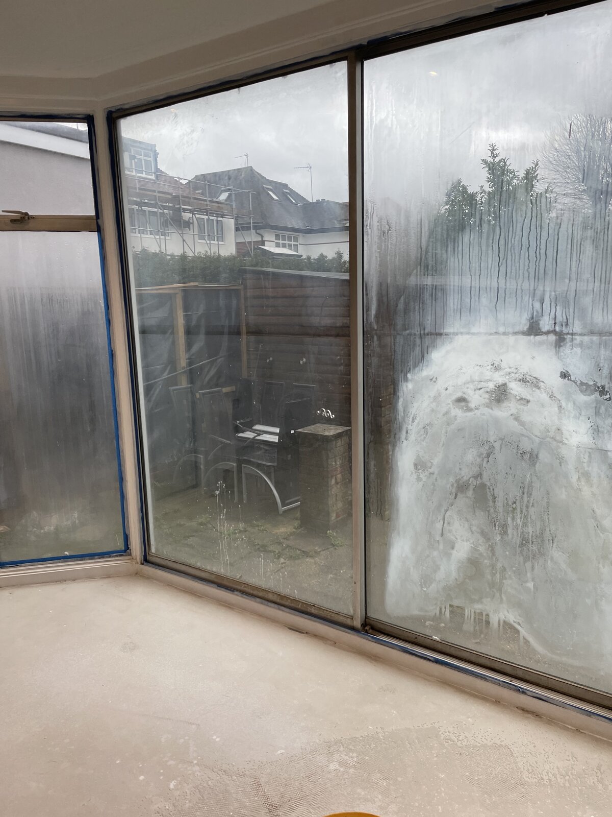

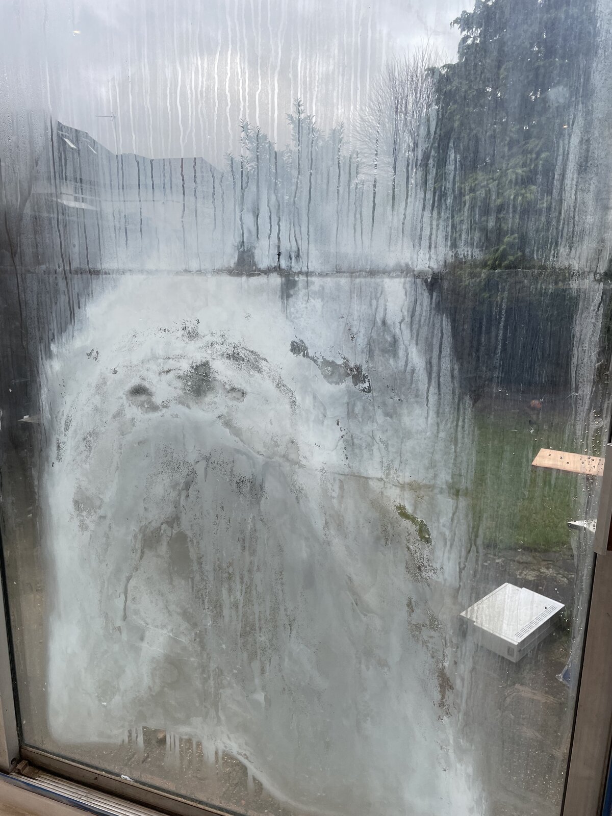

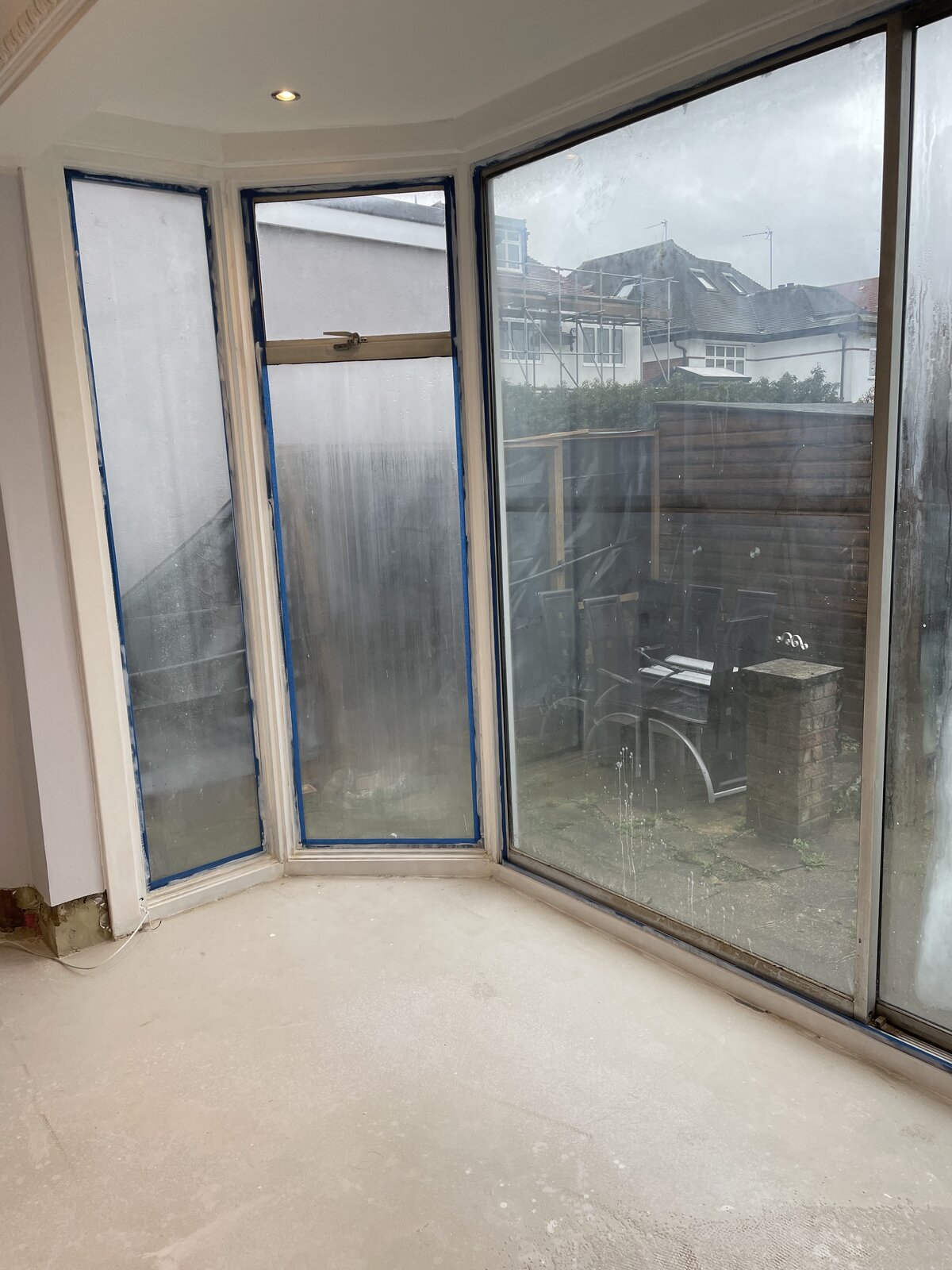

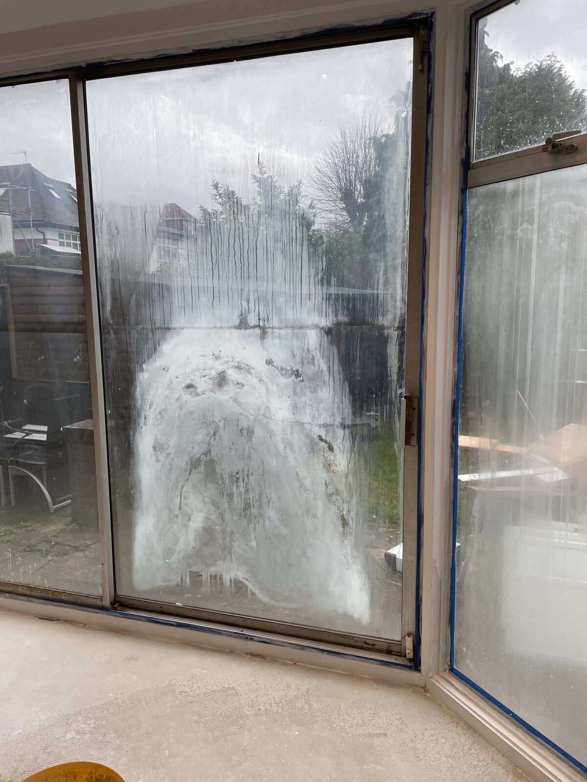

I have some aluminium frames which are a good 20 years old - They still work but the glass has blown on a few of the panels - This has got worse over the last five years and was noticeable ten years ago
Speaking to glass manufacturers they are looking at 3K for supply of the glass only plus vat and delivery
Is there any way these can be saved or do I need to use my emergency funds to replace them

AND stay away from those who claim to be able to demist/repair them - firstly you'd never get rid of the white staining , secondly they would no longer be sealed units and most of those are toughened so they'd not be able to drill them , which is what the ' repair ' is

Don't know what Ronnie thinks but looking at the age of those frames I would hazard a guess at those units being 6/6/6 plate, if so and if possible on the glass thickness calculator I'd be inclined to change to 4mm glass as it all has to be toughened anyway, the top openers can be float glass so long as they are above 1500mm from ground level otherwise being within 300mm of a door they also need to be toughened, when I say toughened I mean safety glass, laminated or toughened
Not sure about thickness but do suspect 6mm glass and they also look like they are very close to having to be 6mm again, would need a visible glass size to confirm though.
The side panels could certainly be 4mm tough glass though

I put the size 1400MM * 2400MM 6mm glass and the price is £932 for the glass only - Is there any reason it is so expensive - I wonder if it is worth getting new doors completely at these kind of prices
