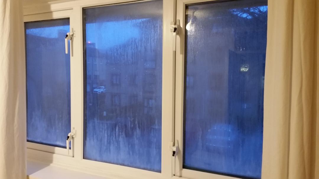

Dear all,
I have these three windows where the double glazing has failed.
Before asking for a quote, can they be fixed or do they have to be replaced?
Anyone has any idea how much can it cost ?
many thanks
Plenty of companies around that replace them if you dont want to do yourself.
You cant repair double glazing.
Its a bit crap theyve all failed, I wonder if theyve been got glazing shims at bottom and blocked drainage holes
Id guess about £50 per glass.
You can replace the glazing units. There are online places where you can get a price, or get a glazier to order them in, or get a glazier to supply and fit them. I'd guess somewhere between £20-40 per unit supply only.
Edit...Notch7's pricing is probably closer than mine, I pad about £50 for a smaller one but it had georgian bar in it which increases the price.
That's an oldish window, external beading and cockspur handles give it away, at a guess I'd say at least 20 years old so units are at the end of their lives anyway
