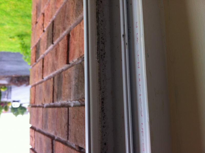

Just to confirm it's the gaskets/seals around the opening windows. Looks as if we also have issues with the gaskets/seals around the front, rear and french doors. The front door is wooden/plastic. The rear and french doors are upvc.

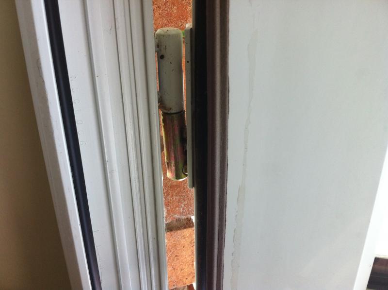

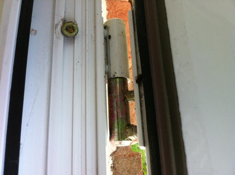

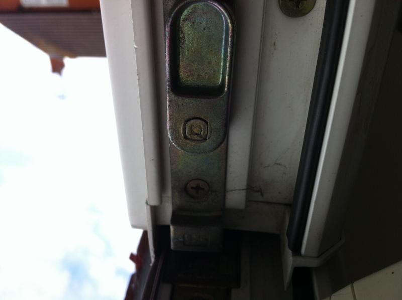

The French doors have additional problems in that 1 of the hinges looks as if it is bent. When the doors join in the middle there is around 5-10mm gap. Also, the french door that generally remains closed - you can push the door forwards and back by around 5-8mm even if it is locked in position.
The seals look like they've seen better days. On closing any of the windows there doesn't seem to be any resistance any more.

I'll try and load up some pictures for the French Doors.
Post some pics it should be adjustable and if the hinge is bad we may be able to find a replacement.

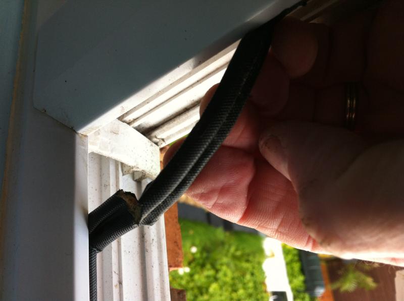

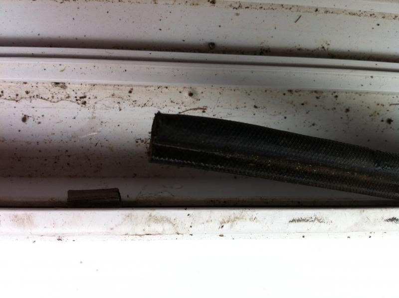

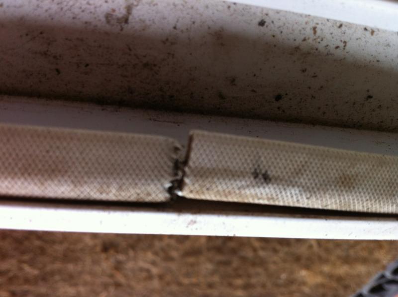

I've uploaded some photos.
Looks as if the window and rear door seals can be easily removed.
The French Doors and Front Doors seem to have glued in seals.
For some reason the photos have decided to turnaround position!!
They are Q lon gaskets for the most part.
Have a google/search ebay for Q Lon gaskets. Find the nearest shape and size to yours and then order a small amount (enough for 1 window) to test it.
On this keep here. If you loosen the screw with the arrow (there will also be another under the slave door) slide the keep to the inside and then tighten the screws. Do the same for the top keep too. This should pull your doors in tighter on the closing edge.
Im not familiar enough with those hinges to give you step by step adjustments. Hopefully someone else here can help with those.[/code]
