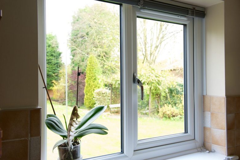

1. So with regards to this point, I meant only one glass panel/unit is marked. The window has two glass panels/units which are side by side like this (that's not my actual window):
The unit on the left has a safety glass mark, but the unit on the right doesn't. Does that sound ok? Should both be marked, or is it enough to just have one mark for the whole window? Sorry I wasn't clear int he first post.

Quite possible to have one tough and one not in that window. Providing the glass in the one that hasn't got a mark on is over 800mm from the finished floor/ground, inside and out , then that is ok.
Having A rated you will indeed have a coating, the glass should be Diamant ( 'low iron ') , warm edge spacer, argon gas filled and Planitherm ( possibly Pilkington K ) low e glass. There should have been a label to indicate which way round the unit should go
No, they are more or less the same height as each other. Definitely both under 800mm.
So should each individual unit have the mark? If the unit on the right has no mark, does that mean it is not safety glass? ***head slap emoji***

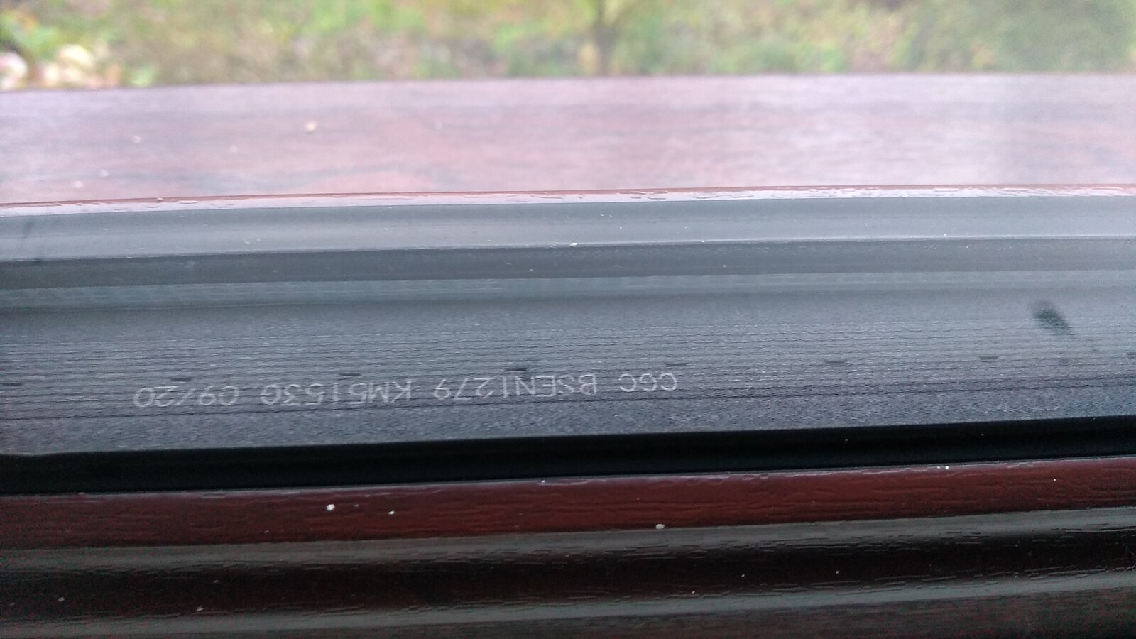

I didn't see the glass panels before they were fitted, so no idea of they had stickers. All I know is that with some panels the spacer bar writing is one way (facing inward) and on others it is t'other (facing outward). Hopefully that just means that they stick 'em in any old how at the factory. And I'm fine with that. So long as the panels themselves have not been put in the wrong way around, then I'm happy. Is there any other way to tell whether they are the correct way around?

If they are the actual glass is below 800mm ( not the frame ) , then yes , both should be toughened.
Very unlikely fitter has put in incorrectly, majority of sealed units are manufactured on automated lines these days and won't differentiate the way the printing on the bar is facing, so I suspect all is well

Hmm, I can't see anything there that will help me distinguish whether mine are C, B or A. The spacer bar is black on my units. Would a photo of the spacer bar and/or a photo of anything else help? Would the BSEN number help, or is that the same regardless of efficiency?
Cheers
The BSEN number will be the type of glass eg , toughened , laminate etc it won't identify the make up of the unit .

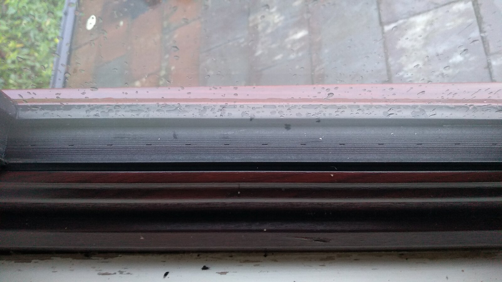

If you have a photo of the spacer bar then I should be able to determine whether its ali or warm edge.
Thank you so much. They're not the easiest thing to photo, so I've taken three. Let me know if you need me to take more/take the differently. Thanks again.
IMG_20201208_142936582.jpg IMG_20201208_143012325.jpg IMG_20201208_143022391.jpg
Thats a warm edge spacer. I suspect you have the 'a' rated version as its unusual to see B rated used.
Please note though that the sealed unit on its on is not energy rated and if old upvc it is highly unlikely you have an A rated frame, what you have is an untested frame with a sealed unit with a u value of 1.1 , but considering the frames are older, without going to a lot of expense, its the best you will get
