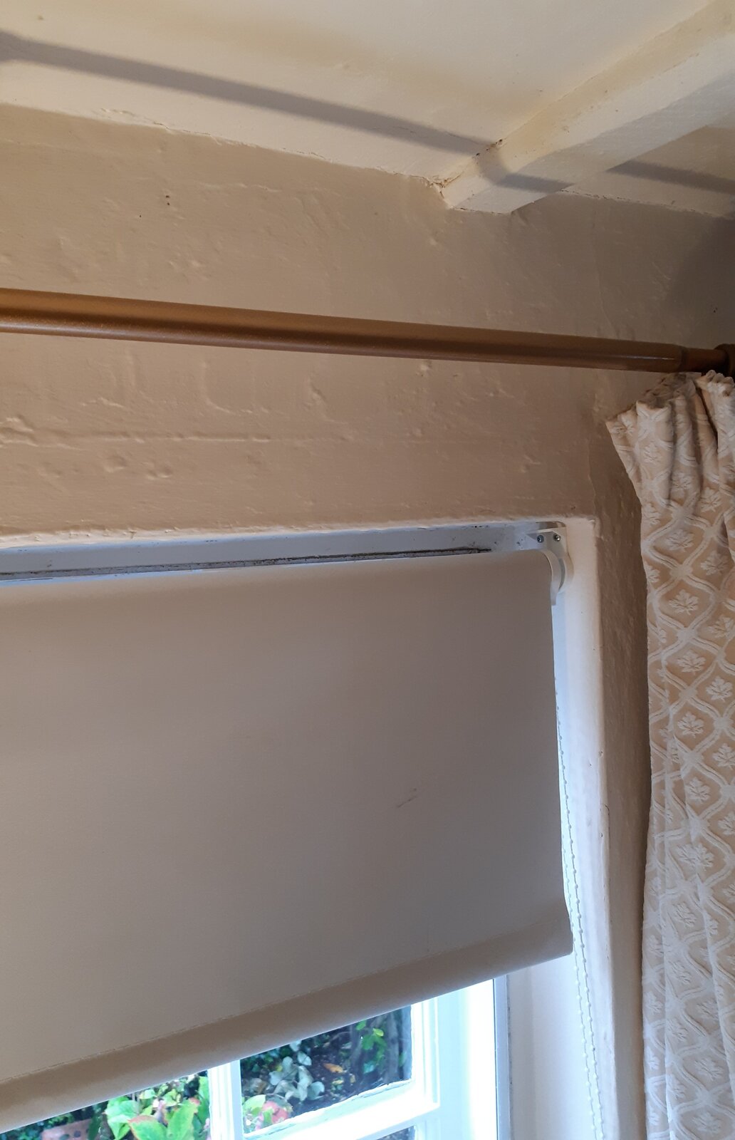

In my old property I have a ground floor wooden framed window. The frame itself is sturdy and sound. But the wood around the small windows have deteriorated and need frequent maintenance. I would like to replace all the wood with double glazing. However I don't fully trust the lintel.
Is it possible to have double glazing with a frame that is made of plastic covered metal that the uPVC would fit into?
I can support the lintel with an Acrow prop whilst it is being fitted.
Plastic nor aluminium windows should never be relied upon as structural, the frames should not touch the lintel but have roughly a 5-10mm gap, your lintel should be taking all of the weight not the window
That is a good point you make crank39 about the lintel. But just to be on the safe side the metal frame I was thinking about would be a thick steel box section square tube across the top and at the sides. To which the uPVC panel would be fixed.
It would be more helpful to find out why you don’t trust the lintel.
lots of houses don’t even have lintels and never fail if there is enough brickwork above locked together.

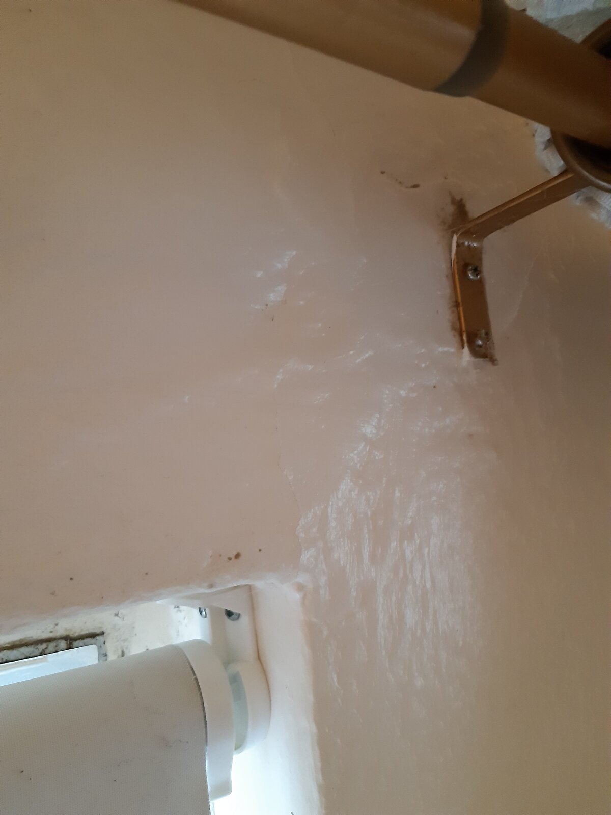

Thanks Notch7. The outside wall is pebble dash applied many years ago. On the inside wall from the images, you can see a lintel above the window. It's 2 1/2" thick and has a sloping end to it. It's probably concrete. The other end can't be seen so clearly but scraping away the emulsion a hairline crack is evident in the sloping part. Perhaps a helical spiral bar above the existing lintel would be a better bet than my steel box square tubel idea.
