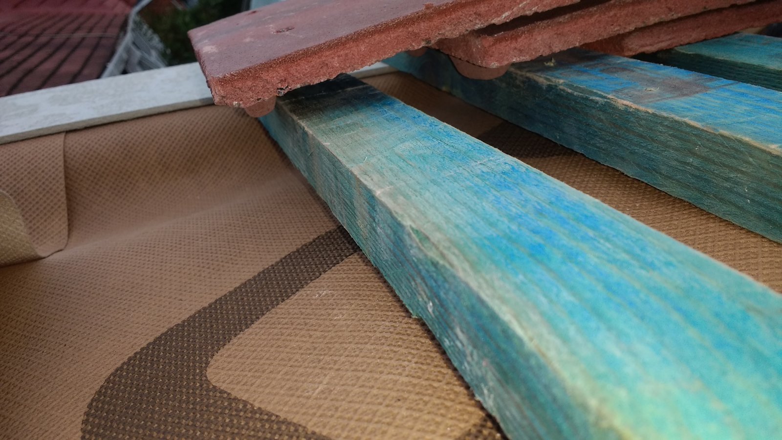

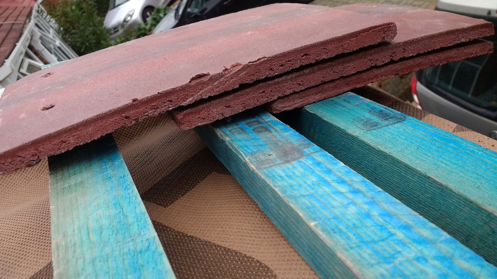

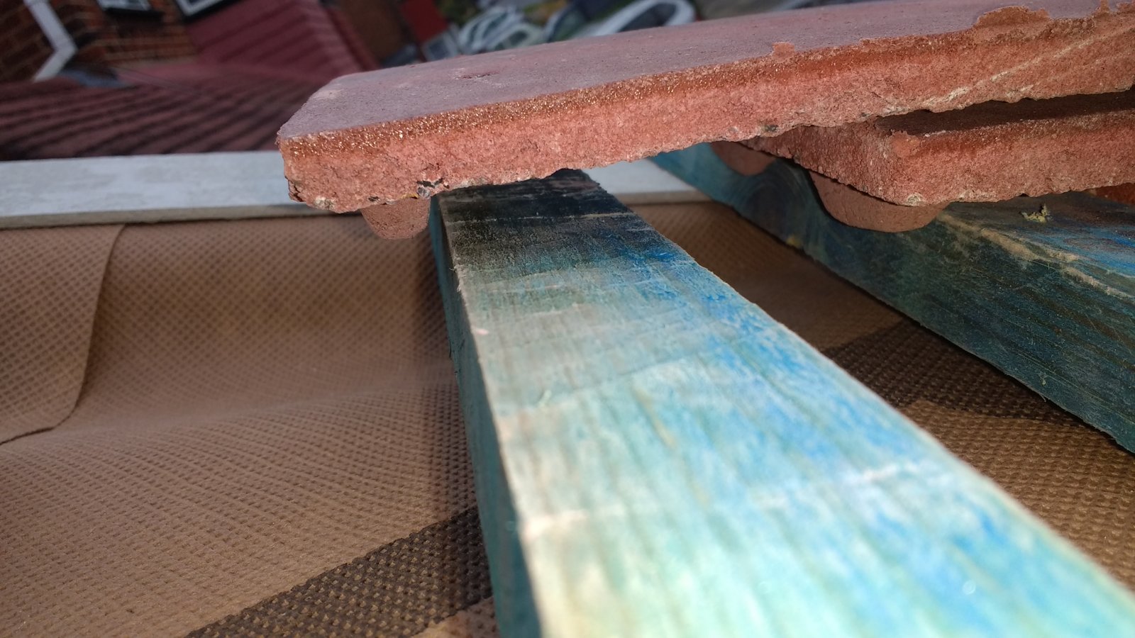

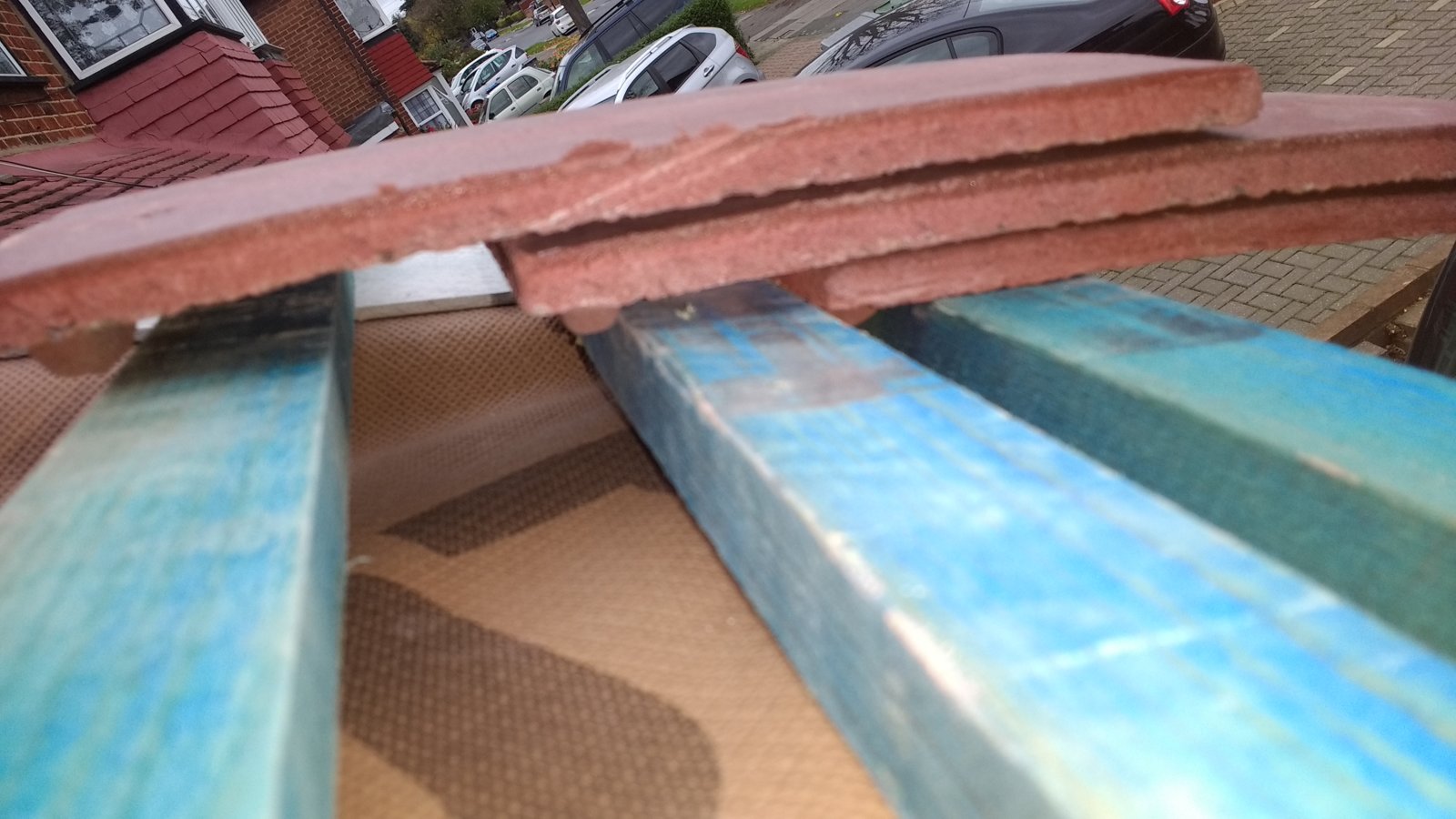

Made a start today and run into a problem with the eaves course and next courses..
Ive setout battens to check that im doing it ok...put eaves tile first then a full tile ontop..then set another batten..but wheb placing a tile onto this one it doesnt seems to hook properly onto the batten..see pics..it just doesnt quite seem right.
Any suggestion?

you need something to support the eave at the correct height . This can be a fascia or even an arris rail. Your pictures seem to indicate they are unsupported.
Having said that the gauge (spacing)
images
looks fine
Pitch is around 40 degrees.
I will put the fascia to support once ive got the setting out correct.
I have actually screwed down the eaves and 1st course of tiles temporarlily just to help with settting out..
So eaves and first course is full tight to battens. Is this the correct height? Or is this where the adjustment needs to happen?
Looks like the fascia is too low.
The pitch looks low.
40 degrees a nice pitch for plain tiles. camera angle makes it look more like 20.
it is normal practice to set the roof out between fascia and abutment/ridge.
doing it without just makes life awkward as you have just found out.
