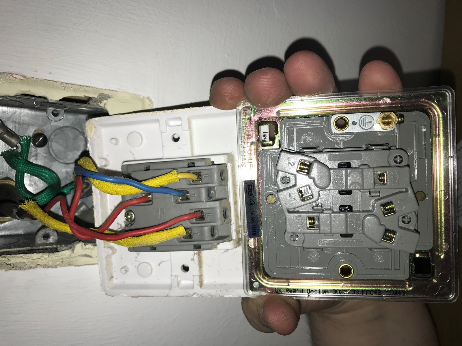

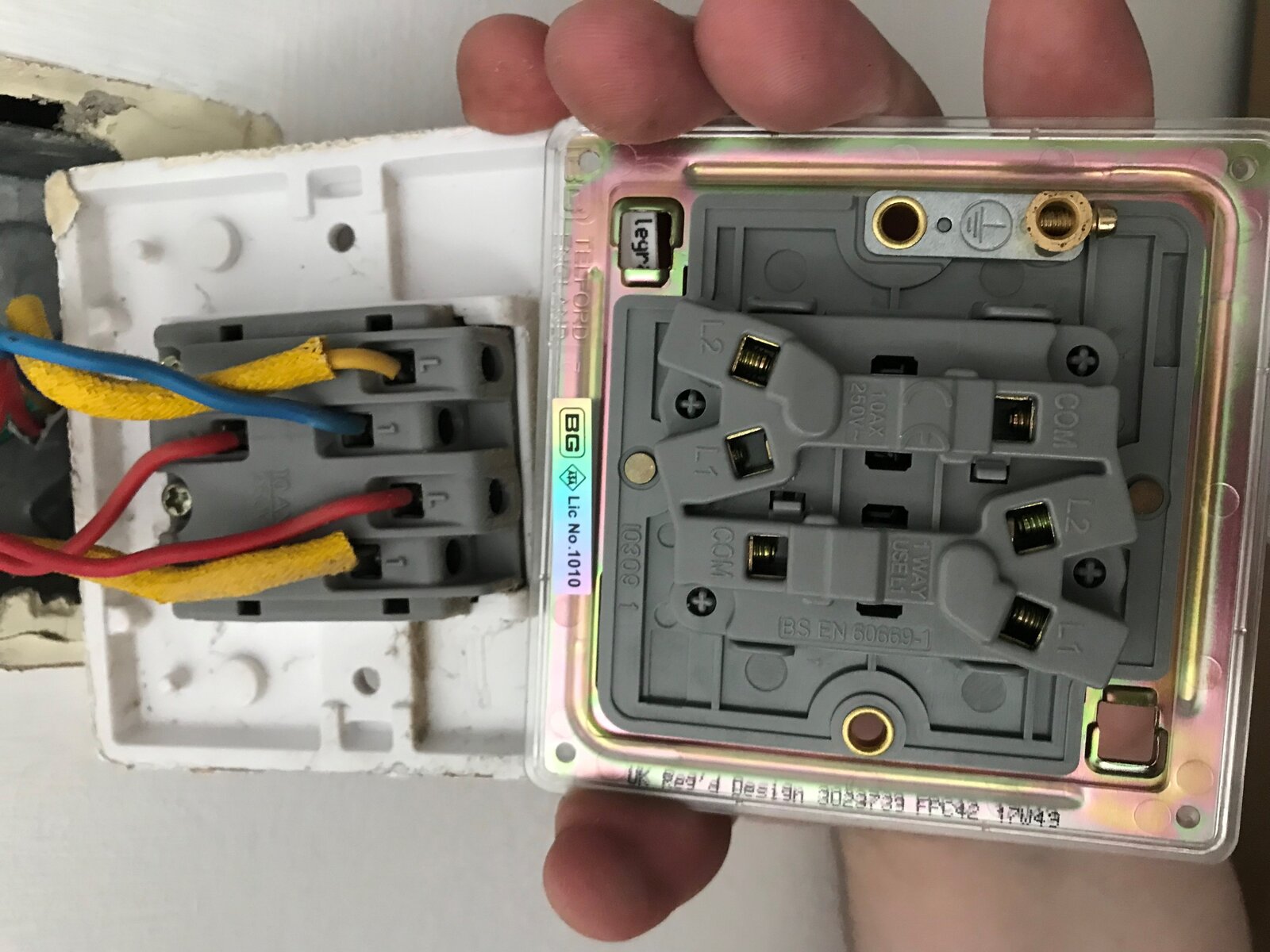

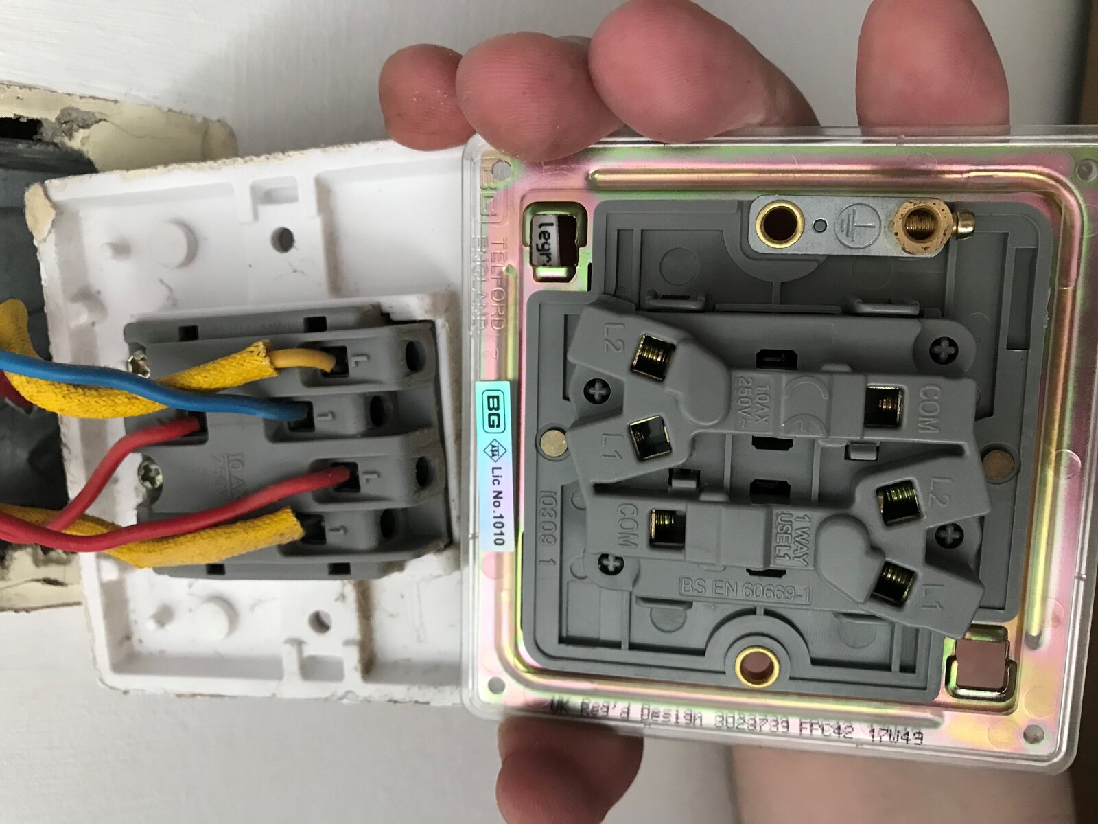

Hi Gang, Just found this forum and was looking for a wee bit of help regarding fitting a double light switch. I know it has been discussed lot, have read them all and I kinda think I get it but Im just wanting to be double sure. Could any of you kind people tell me the way to wire this exact socket.
I am thinking if you look at the pic with the old socket at the top then from the left it would be. Yellow to L1 Red to Com. The Red to Com Yellow to L2 and the blue(which is throwing me off) to L1?
Any help would be appreciated. Sorry if it been asked to death now.
Cheers,
Will

2 wire switch correct can be either way or you may need switch L1 to L2 if they don't rock how you want them to. Other one Yellow to common Blue to L1 Red to L2
Thank you!, appreciated.
Just so I understand. In the first pic from left to right(if the photo is upright with old socket with wires in at the top).
Yellow 1 over to new switch L1
Red in L over to Com below it.
And other side
Red over to Com at top.
Blue over to L1 at the bottom
Yellow over to L2 at the bottom
And off course Earth into the Earth.
Sorry for being a Moron.
