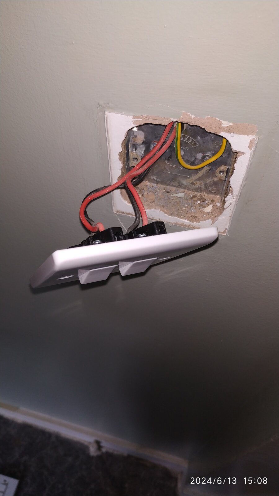

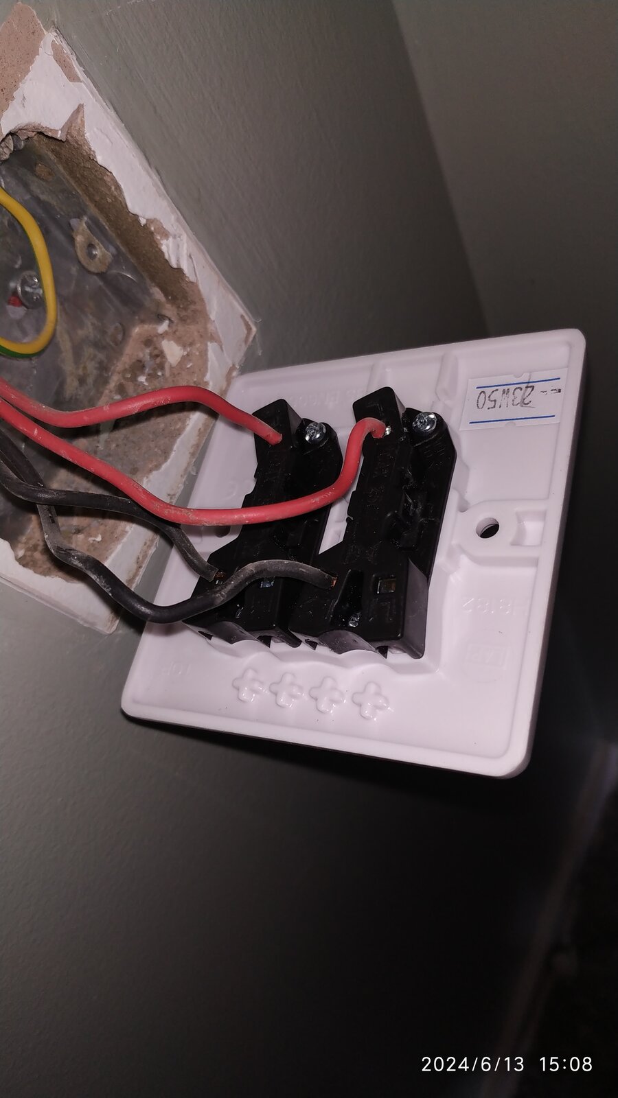

Hi,
I have a double light switch in the kitchen. One side switches on the ceiling lights, the other side was left by electrician for cabinet lights in the future. Kitchen lights working perfectly.
Coil of wire from the other side of the switch in the loft. Today I added a socket to it to test (it will be a plug in 12v supply) but switched on or off it's dead.
Pictures attached of the switch and wiring? What is not correct?
Thank you in advance
Pg
You don't have a Neutral.
You can't just wire a socket - or a light - to the two wires from the switch.
You will need to connect the socket to a supply and then have the switch wires interrupt the line(live) conductor.
Of course, yes I take that back about neutral, it's just a black wire, 2 of them, one each side going into L2, red into L on each side.
So the roll of cable in the loft I can just choose to be neutral (red in, black out) l then run a separate feed into the socket, live, the one in the loft to the existing lights would be suitable, and so makes or breaks neutral.
It was the red/black and one side working that threw me
Thank you !
You can't do what you want. There might be a junction box somewhere up in the loft though have a look. As EFL says they are switched lives for the lights not neutrals.
Ok, yes. Post crossover, I'll use these as lives, take neutral from loft, probably still the lights but I'll check first.
I feel a bit of a tit but if I hadn't asked I'd be looking at this completely wrong. I basically wired a plug to a dead switch !
I'll locate a suitable neutral feed, join both Ls on the switch to give me live and use the red wire out L1, I'm happier live being red.
Thank you, helped me a lot
