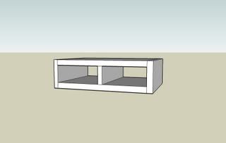

Actually Ziggy that's completely the wrong way of going about it. The frame below the table top is traditionally made-up from flat members and the drawers are built into a sort of box structure, a bit like this:
OK, so in a traditional table these elements would be smaller and you'd have narrow rails at the front and rear instead of flat slabs, but the fundamentals are the same. Build a box like this from 5 parts with a divider to separate and guide the drawer boxes and put a back on the this box and that's the top of your table made. If you want an overhanging top this is best added when you've built the rest of the table.

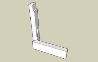

The legs (assuming they are solid wood) can be halved and then screwed from the inside of your top box to support the top of the table:

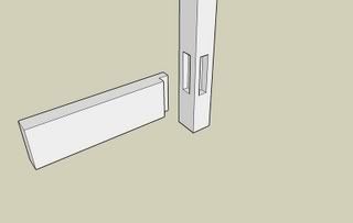

but the bottom of the console table I showed actually has a solid wood framework with either mortice and tenon joints or (for production work) dowel joints. The simplest way to make this framework is to use something like the bare-faced mortise and tenon like this:
The shelf and top are then just pieces of sheet material supported on the lower framework and top box respectively.

Here is a better pic of the traditional joint methods, hope it does not put you off ;)

2. Ideally I would like to have a wider separation between the two drawers (say 1.5" between the leg and the drawer and 1.5" between each drawer. Other than the fact that its probably incredibly difficult to plunge cut two holes for the drawers from one piece, is there any other reason why i shouldn't try doing this (e.g. will it make the table flimsier in any way)? I thought it could be made easier using a router jig like the one Trend has to cut out for letter boxes in doors.

There is no reason why you can't use dowels but you will need to make a simple jig to ensure the holes line up and are all set back an equal distance from the table leg/rail edge.
You should be able to use the router to cut the mortices in the legs, if you use the fence that comes with the router you can set this to make sure the mortice if the same distance from the leg edge, or make a simple template and use the router in conjunction with a guide bush.
You could cut the draws using a rectangular template, it would be best to remove most of the waste with a jigsaw then tidy up the cut with the router, you will then just have to square up the corners with a router. I don't see it being much weaker than separate top & bottom rails on the draw side of the table.
