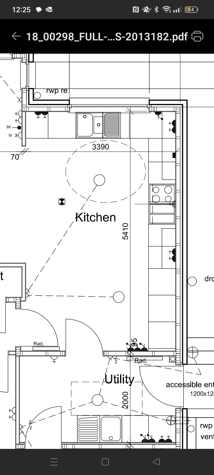

Hi, looking for suggestions on where/how to layout down light spacing in my kitchen. I have cabinet lights to illuminated worktops, just looking to mark out the ceiling and hope I don't hit joists when I come up with a layout.
Think if I do a nice uniform pattern it looks odd in places as there are units/cabinets on one side and not on the other?

Personally I have always found the centre of the available ceiling then spaced down lights as close as posiible to 1 metre apart in both directions
Most downlights have a minimum space to nearby items, like joists. Hope doesnt work in this situation.
Find where the joists (and anything else in the ceileing, like pipes, other cables etc ) before you make your plan. And also BEFORE you start making a swiss cheese out of your plasterwork.
Also decide where the cables interconnecting the downlight might need to go.
Just plan plan, or you'll need a ceiling repair man and you will have to do it twice.
Remember, if you fail to plan then you WILL plan to fail.
Been there done it.
PS. Put the lights where you want the light to be on the work surface. ALWAYS have a light over the kitchen sink and any other surface where you (or the home help) will need to prep or cook. NEVER have the light behind you or you'll be working oi your own shadow.

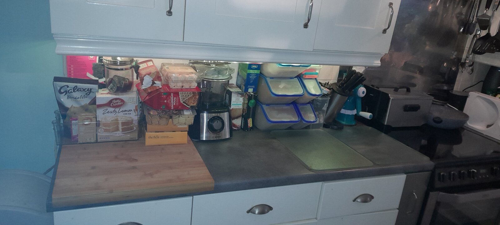

GU10 lamps in pods can be adjusted to aim at where required. I fitted lights under the wall cupboards 1730734905492.jpeg so not so important for the ceiling lights to be aimed where required, just as well, since all grouped together, but the main problem is how to run wires, think I will go with lighting track, so it does not look like an afterthought, even if really it is.
Yeh, it's my house. Couldn't afford the housebuilder to install them when we moved in @ 120.00 each. In the corner of the kitchen there are 3 X ceiling height (almost) larder units fridge, freezer and oven/microwave larder. If I say come out 200mm from these in a row of say 4 along the 5m length, that would mean to balance a second row it would need to be 800mm from the wall with the door and it looks odd I think? Hope that makes sense. So should I come out from worktop/larders say 400mm and same from other side (wall where door is) 2 rows of 4. I have good under cabinet lights so shadows should not be an issue? Just wondering what guys that do this all the time would choose
