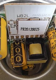

We tend to consider faults as we would likely find in our own homes, I have questioned many times why LED bulbs flicker, and I am lucky up to date not had a problem with an integral lamp, I have not reverse engineered the more complex LED bulbs, but there is clearly a lot in them. 20220603_113820_small.jpg shows inside a GU10 bulb which failed for me, I am not likely to find the circuit diagram for the chips, or work out why a bulb flickers.
