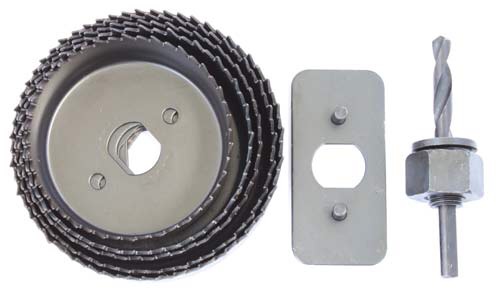

Joking aside, it's a pain indeed if you would use a jigsaw, which is not recommended; when all you have to do is buy a hole cutter attachment for a standard drill, that'll cut through your plasterboard AND the wood strips.

You really need two holesaws... an old or cheap one to get through the plaster (it'll blunt it quickly) and a half decent one to do the laths (it'll burn the wood and cut salowly if you use the blunt one... and then snap them in a rough manner when you get ****ed off and force the rill as its getting nearly through...)
