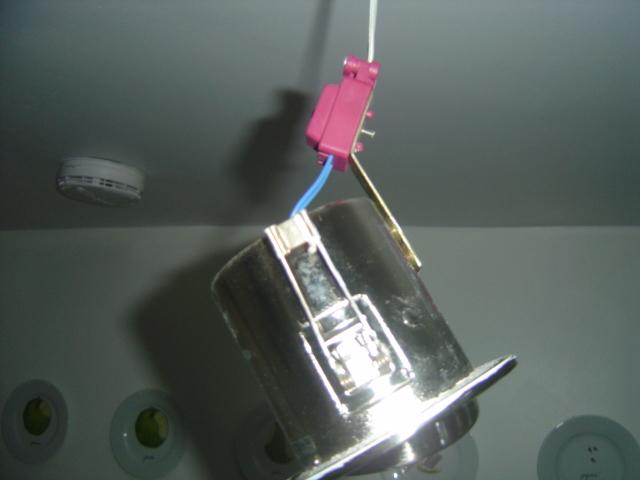

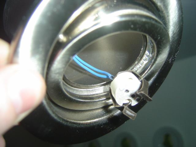

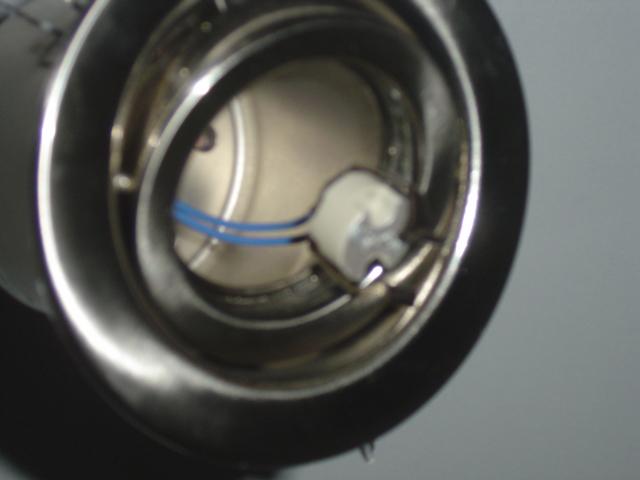

I may have misled you when I said the ceramic holders were an integral part of the fitting. They do just hang down on wires but I couldn't see how they could be removed from the whole thing. Once I worked out how to get them out of the ceiling they just go to a small terminal block that sits above the fitting itself.
From what Cremeegg has said I may be able to replace the ceramics easily to use a process of elimination before forking out for anything else.
Are these ceramic things the sort of 'Lampholders' you were talking about, Vansolo?
I will try to email you re your offer.... and thanks again!
On a probably unrelated note, the incoming cable looks very thin on the pictures, any idea what type/size it is? I assume each fitting has its own transformer?
