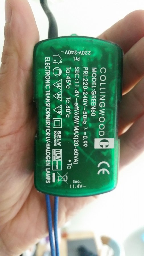

Hi guys thanks for the reponses, it is difficult I know. Below is a picture of how thw lights are set up and working (o) / not (x). 1,2,3 represent three seperate light switches, so when i turn on 1 the 1st, 3rd and 4th lights turn on. I have removed the light fitting not working on switch 2, and this had the transformer (see pciture attached). I have not removed any other fitting to see if they have a transformer.

They will have transformers if your using 12V lamps.
It is the most likely fault that tranies have failed, but don't rule out faulty lamps, lampholders, loose/damaged cable/connectors or a combination of them all.
I have changed the cables and these are not burnt out, but I will check loose cabelling as they were working before. I will also try to find a working transformer and replace this with the faulty one. Thanks for the help so far.
Two things, one it says "Electronic transformer" the electronic is important, second it says 20 - 60 VA, as far as you need to know VA is the same as watts, so what it says in layman's terms is the transformer will work with a bulb between 20 and 60 watt, in the main LED bulbs are under 20 watt so will not work. The word electronic tells us it may have an output which is not 50 Hz, many LED bulbs are actually marked 50/60 Hz so are in theory not suitable.
So likely the electronic transformer is the problem, if the bulb does not state 50/60 Hz then likely you can use a suitably rated electronic transformer as linked to but to be sure it needs to be like this one
to work with LED bulbs normally found for sale.
