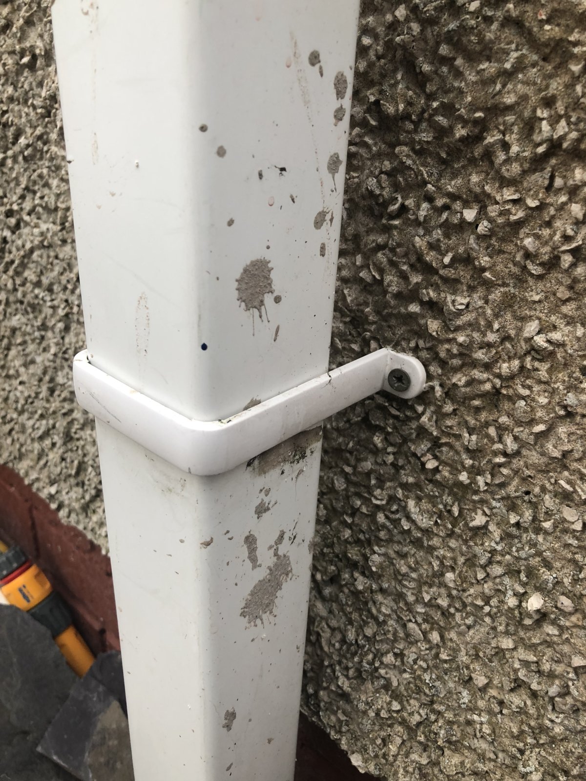

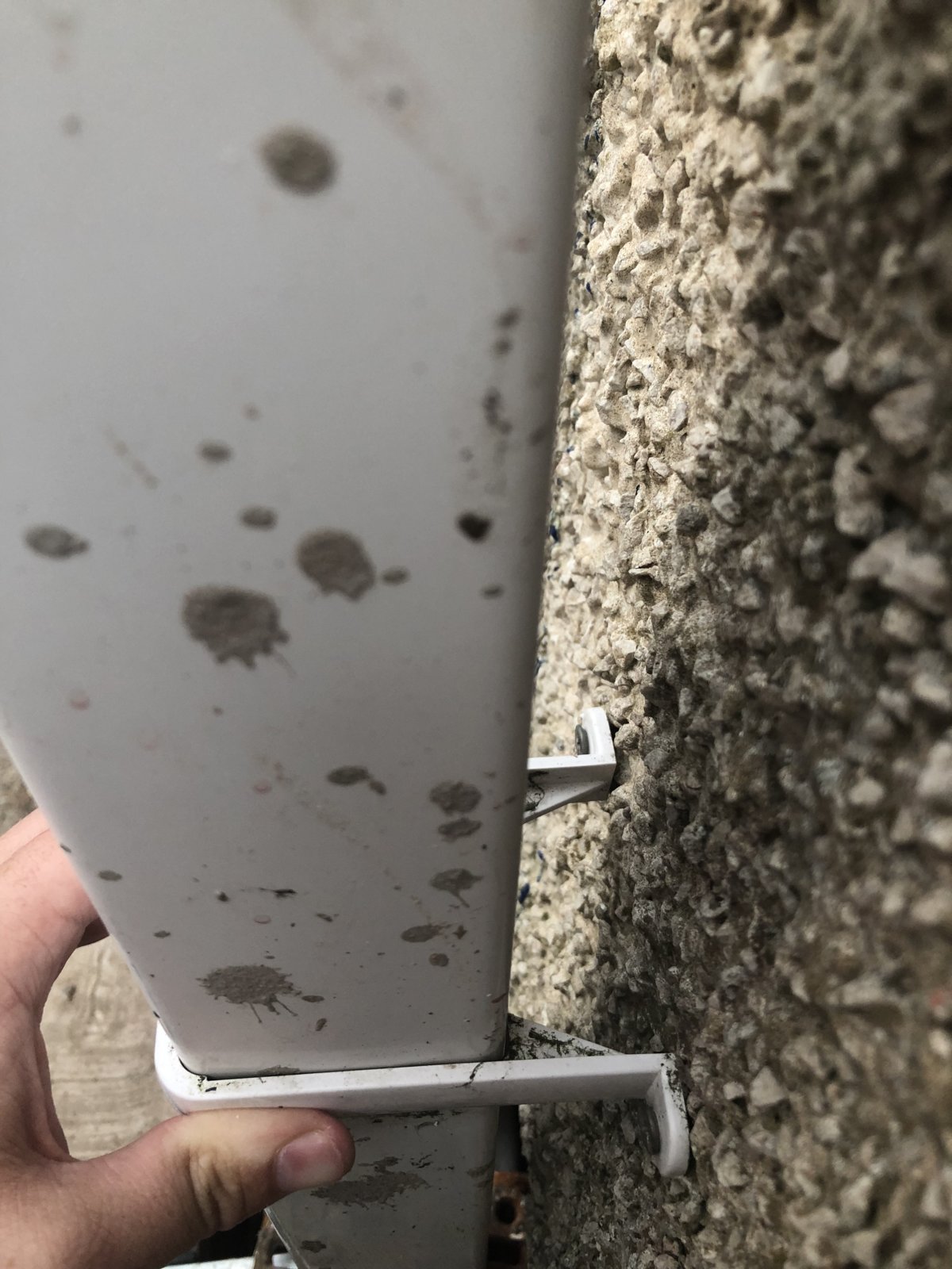

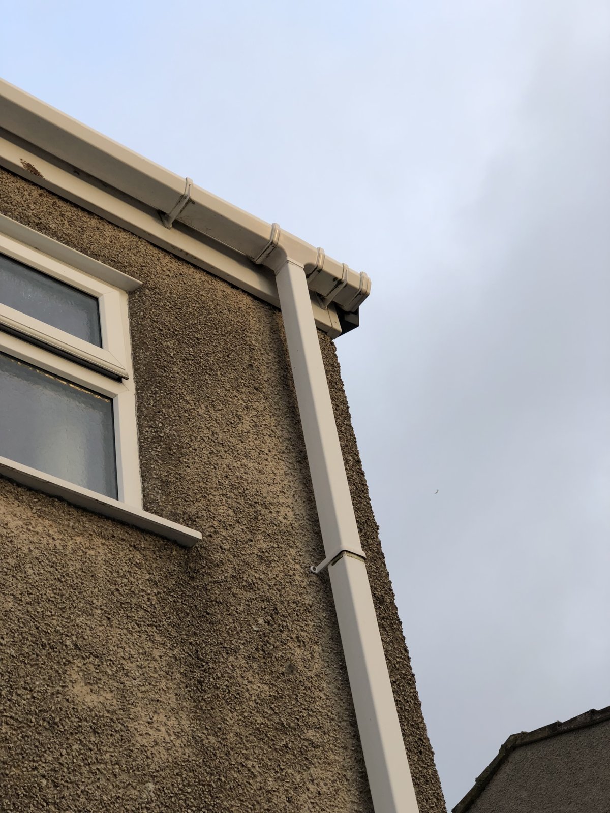

There are clips attached, but they don’t seem to hold enough to stop any vertical movement (see photos above)
There’s no swan neck, it’s just a straight drop from the gutter outlet
angling off the outlet like that needs packers behind the clip ears - we us small 15mm copper offcuts. but dont bother messin with it.
with tighter centres drill new plastic plug holes at a slight angle an use longer ss screws to pull the clips tighter.
the plugs must be in the masonry behind the dash an render.
if you dont want to work off a ladder then force the down pipe back up - its only dropped about 25mm an drill an screw two clips one about 300mm from the bottom an the other about 500mm higher.
but first hack off the little angled stretchers at the back of the clips. this will allow you to get a tighter grip.

This is what I ended up doing and it’s worked a treat. Thanks
