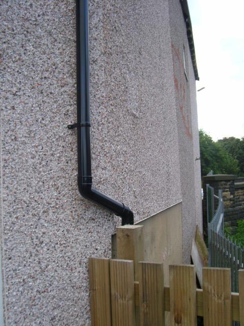

Hi,
I recently had a downpipe fitted to my gutter, however the it does not lead into any drain or any type of soak away it just stops at the bottom of my wall? I'm pretty sure this doesn't meet with building regs but don't know what my options are. There does appear to be some sort of drain right beside the new downpipe but not sure what its for (toilet waste). My toilet waste drains into another drain about 4 meters away so not whether i should get the guy back to run the downpipe into that?
any advice would be much appreciated. I have added some pictures for clarity.

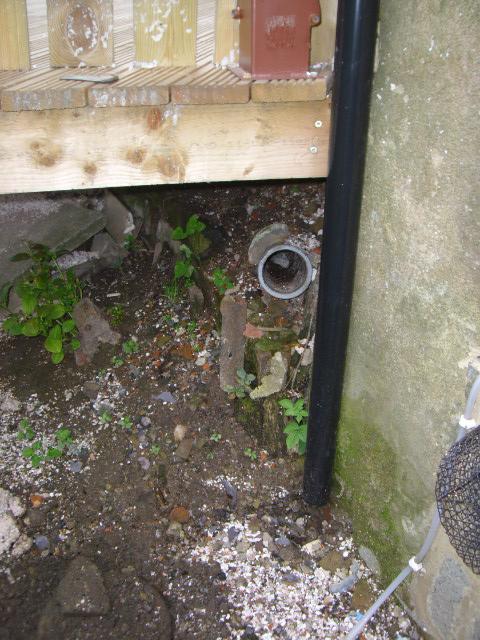

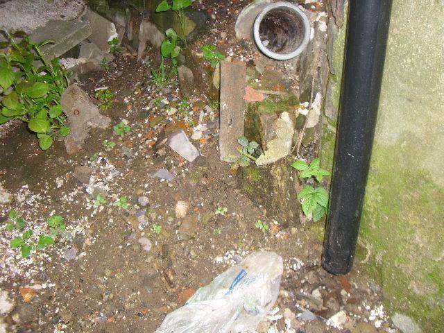

Nope, asked him to fit a downpipe and he did it. He advised that the water would just drain away from the house and as im totally new to this i took the professionals word for it. Its only after doing a bit of research i found out that this is not right.

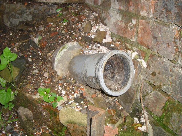

When i went down and had a look around and clear out some rubbish that was lying around i notice that drain inlet.
My question is, should i get the downpipe to run into that drain inlet. i'm not sure whether its a drain for waste water and i was under the impression that you can't run your rain water into your waste pipe as it will cause it to overflow. But i'm not sure if this is the case and this is why im asking for some guidance. i dont even know if that drain works or has been blocked up.

Well he sure did that! No, he’s not a professional, more a cowboy; but he did do exactly what you asked! No it’s not acceptable to allow surface water from the roof to “just drain away”.
When i went down and had a look around and clear out some rubbish that was lying around i notice that drain inlet. My question is, should i get the downpipe to run into that drain inlet. i'm not sure whether its a drain for waste water and i was under the impression that you can't run your rain water into your waste pipe as it will cause it to overflow. But i'm not sure if this is the case and this is why im asking for some guidance. i dont even know if that drain works or has been blocked up.
You need to establish if the old inlet is still connected, if its working & what it feeds into; if it’s an active surface water drain (mains or soak away) then fine but otherwise no point. You may be able to connect into the foul drain (your nearby toilet drain) but you must find out if your water authority will allow this; many no longer do. Surface/foul water drainage comes under & has to comply with Building Regulations; if you feel unable to complete the work properly yourself, my advice is to call in someone who actually knows what they are doing!

Try putting a hose into it (a lot) & see what happens; if it disappear , it’s obviously going somewhere! Lift your foul drain manhole(s) to see if the water flows through there; at least you will then know if it’s connected to foul drain. If it is & your Water Authority will let you connect (re-connect), problem solved!
