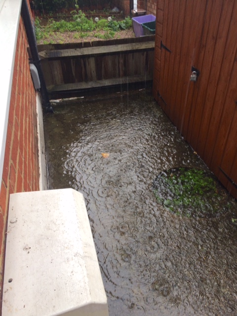

Hello everyone,
This is my first post and just wondering if anyone could help me with a small matter.
We bought the house a few years back but have only just realised that the downpipe from the gutter seems to lead to the front 'yard' which results in a mini flood everytime it rains. I may not be describing it very well but the attached picture should make it quite clear.
Looking at our neighbour's house it seems that the downpipe should run into a drain of some sort. Unfortunately, it doesn't seem to be the case for us.
Does anyone know what can be done to redirect the water? I would really like my front yard to not be a swimming pool everytime it rains if it's possible.
Thank you.
Jo
*Downpipe in the top left*
No sign of a drain being covered up ?
If its a terrace, can the downpipe be removed to cause the water to flow to another downpipe in the run?
That much water would be (and should be) going to a drain or a soakaway away from the house

Definitely no sign of it being covered up unless someone concreted it over or something. I think there shouldn't be a problem removing the downpipe but not sure if there will then be too much water and overflow the gutter.
You'll need to check falls of the gutter before removing a downpipe.
What about a section of downpipe or gutter along the ground near the fence to take the water behind that shed and down the garden somewhere?
Yeah, will definitely have to check the fall. Might have to lift the gutter up a little bit as well to redirect water away if I'm going that route.
Can't really take the water elsewhere. The downpipe leads into my front yard. Behind the shed is a brick wall and behind that is a pedestrian path. So the water really has nowhere to go other than form a pool.
Sounds like you will have to have a gully fitted and directed into a nearby drain.

I think it has but hasn't really occurred to me only until the last few month as I was wondering why is the insides of the shed wet. Do you know who will be able to fit a gully? A roofer or builder?
A builder - but you'll need to find a nearby surface water drain first

Anyway, you can't connect RW to drainage system. It's soakaways nowadays.

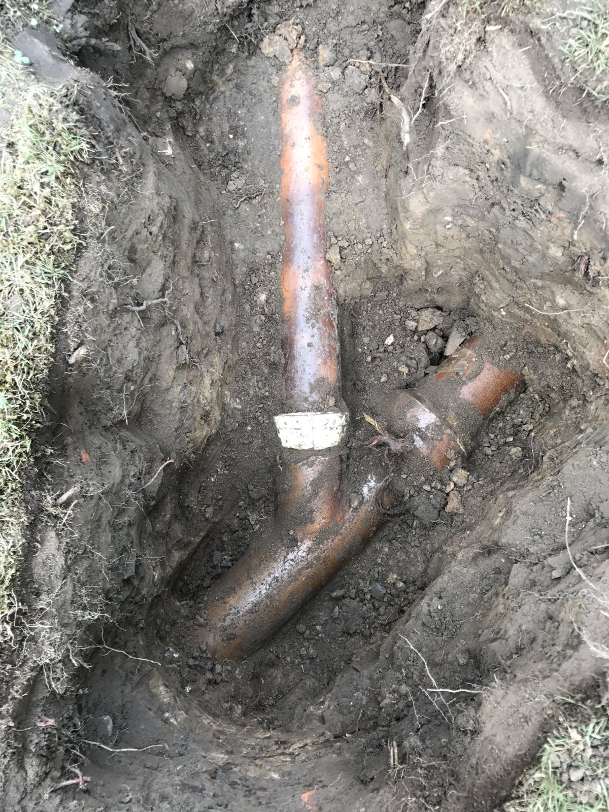

Can you actually see the end of the downpipe? If not have a careful dig around the base of it and see whats been done.
There still maybe a make shift gulley or even an elbow under the surface that might need a clear out.
If not then a soak away needs to be dug. Watch out how you dig. looks like a meter box is near by..

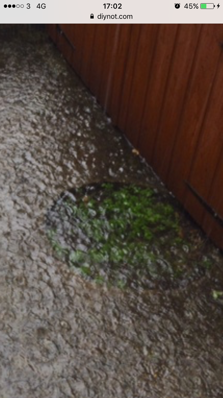

I honestly wouldn't bother with asking for permission. Just get it done by someone who will use the right fittings, so not this guy:
Is this a manhole? That will do.
