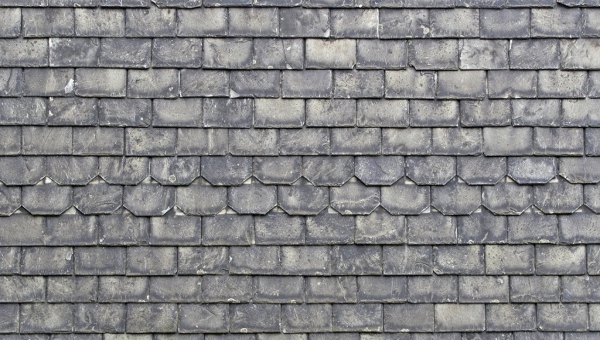

Hi I'm struggling to find any info on the subject of making cuts to slates to for patterns, especially from UK sources so was wondering if anyone on here could shed some light?
I'm sure everyones seen photos or actual roofs with these patterns, I like the look of them but the thought of having a few rows of cut down slates seems like possibly asking for trouble. I realise most if not all these types of slates are only cut on the exposed margin & also retain their centre portion all the way down to the tail to cover the joint in the head lap section bellow it but I wondered if for example trimming the bottom corners off like in the photo attached increases the potential for problems?
Cheers.
Your biggest problem will be finding roofers able to lay slates level like that! Trimming the corners wont be an issue.

Most if not all of the patterned (pictures) in slate roofs for example Brittany france.
Hide something you can not see. Usual zinc soakers . These do the weathering .
The picture you shared is simple and requires nothing out of sight . Stay within gauge for the slate you are using and stick to the side lap rule .
Ah I was wondering how they managed to do the complicated patterns & stay water tight, not that I was thinking of attempting anything like that my self!
