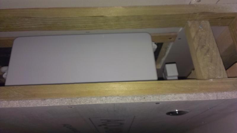

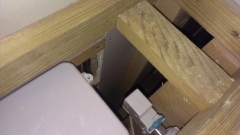

here's some pictures of mine which was done exactly as I suggested.
as you can see my isolation valves are reachable from the top.
the toilet in the picture is this one http://www.bathstore.com/products/euro-mono-wall-hung-pan-1046.html
notice the frame in the pictures (this may not some supplied with the toilet, might have to be purchased seperately)

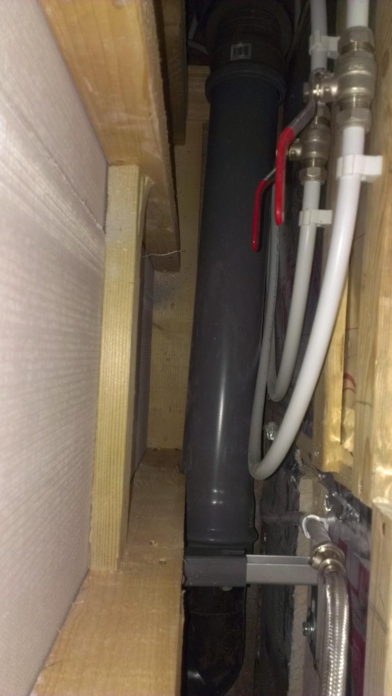

I take it the red levers (in one image) are the isolation valves? Rather then the ones you with a screw that you turn? What position would I be looking from at that image?
Is that plasterboard you are using to secure to front of frame?

The view in that picture is looking down with the top removed. The left hand side of the image is the front (you can see the back of the plasterboard). The right hand side of the image is the rear wall. You can see the large black soil pipe just turning 90 degrees into the toilet at the bottom of the picture. The red valves are isolation for my shower (it's a wet room). the isolation for the toilet is one of the standard screwdriver types and you can just see it in the lower third of that image on the silver braided pipe. In that same area you can see the left hand side of the toilet mounting frame (grey metal) and its mounting to the rear wall.

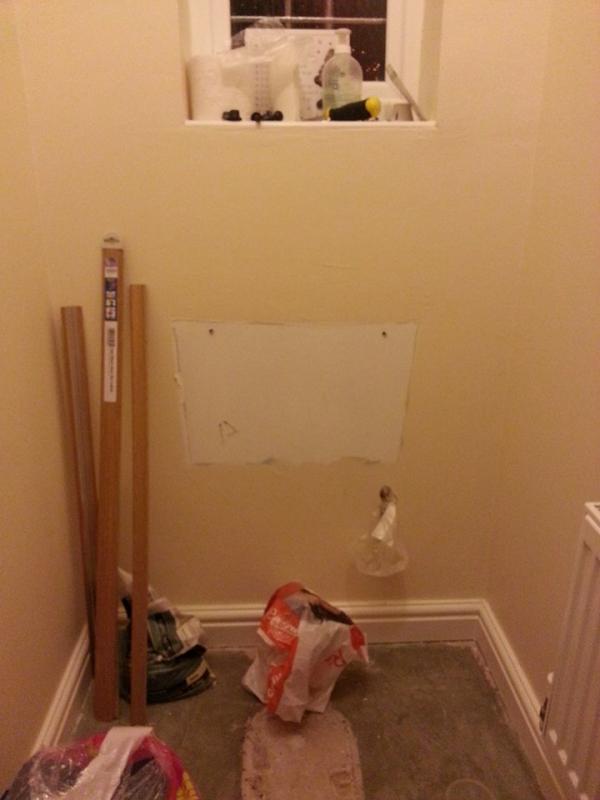

Ok removed the toilet and cistern. Took them to the skip.
Now figuring out which frame and how I will build this stud frame around it as support as I believe the wall behind the plasterboard is thermalite which can crumble. Any thoughts?
I have been looking on youtube. Wall to wall measures 88cm and floor to window sill 107cm.

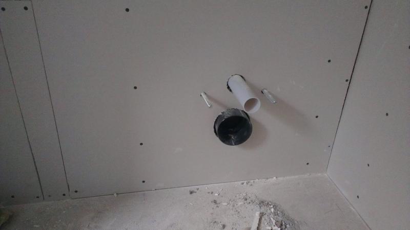

This is what I have done so far. Secured the frame to wall by long studs set in chemical resin. Also secured to the floor. Screwed brackets around frame.
I have 12mm plasterboard ready to cut and box around. But I am still unsure what toilet to buy.

Is it me or is your frame work slightly out of line? This might cause a problem when you come to add the plasterboard.
The plasterboard needs to be nice and tight to the frame or it'll bend/bow/creak when weight is put on the toilet.
