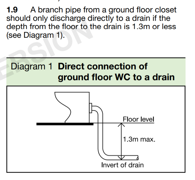

Hi. I had a rear single story extension built I asked the builder to fit a waste pipe for a downstairs toilet.
from what I saw he cut a hole into the top of the clay pipe which was roughly 1.5m deep, around 4mt from my man hole and attached a collar with a 110mm plastic pipe straight up which has a adjustable bend on it ready for me to add to.
The toilet will be pretty much on top of this about 2m up from connection on clay with a shower and sink attached via a boss.
My question is venting my builder said I should add a durgo valve 1m above the bathroom floor, because this is a wetroom With floating toilet and sink I’m not keen on having this anywhere seen.

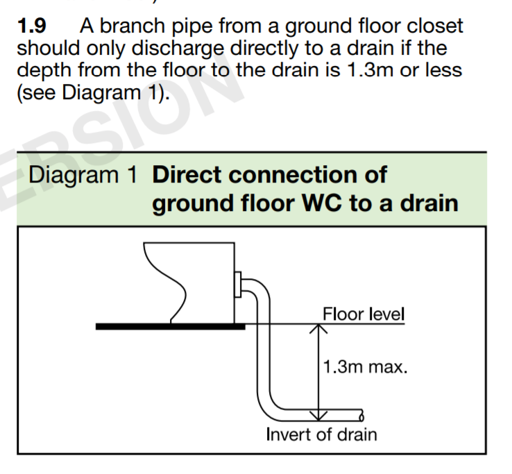

If they are picky this for a start,
The inspector is there to make sure what I’ve done is right not tell me what he wants.
There is your problem before we even start on anything else. The sewer connection should have been checked and approved by the BCO before it was buried, if you cannot satisfy him it's been done to regs, (and if he cant see it he wont know), then he could refuse to sign it off. If he then asks for a CCTV survey to inspect the connection and it's not done to regs, it'll have to come out again and be done properly.
Been to numerous bodged sewer connections where the Builder is long gone, and the first problem the householder finds is the WC backs up. BCO comes out and says works haven't been signed off, householder hasn't a leg to stand on and ends up footing the bill for remedials.
This, and the fact that you're not generally allowed to have a junction outside a manhole.
Also, having your toilet waste falling that far down a vertical pipe straight into a horizontal will almost certainly cause it to go splat when it hits the horizontal and stick there. It'll block fairly quickly. It should enter the side of a pipe via a long-radius bend, preferably at 45° Y-juntion rather than 90° T-junction

The 90° bend at the bottom should be a long radius one, like this. A vertical drop into a tee cut in the top of a horizontal pipe won't provide the same smooth transition of waste from vertical to horizontal
The horizontal above ground in your setup is irrelevant. The issue is the vertical drop into the main sewer
Ye I know what you mean. I don’t think it has one of them given the distance the pipe upright is away from where I know the clay pipe was. I’m only really going off what he told me he did as he’d filled it in with dirt by the time I saw the pipe in, he might have angled it I don’t know.
