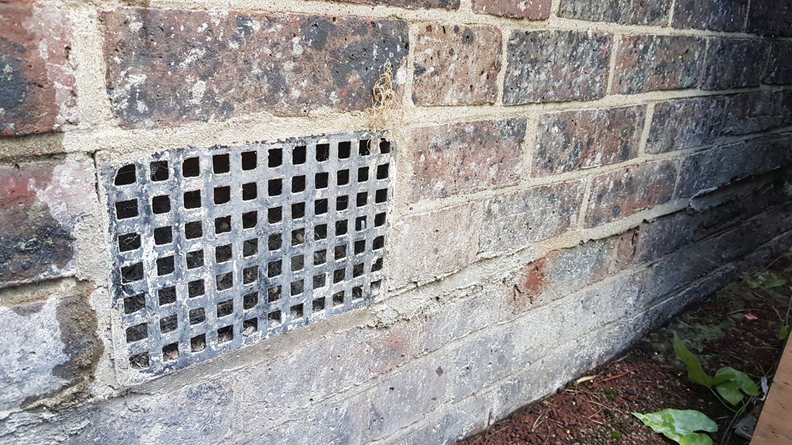

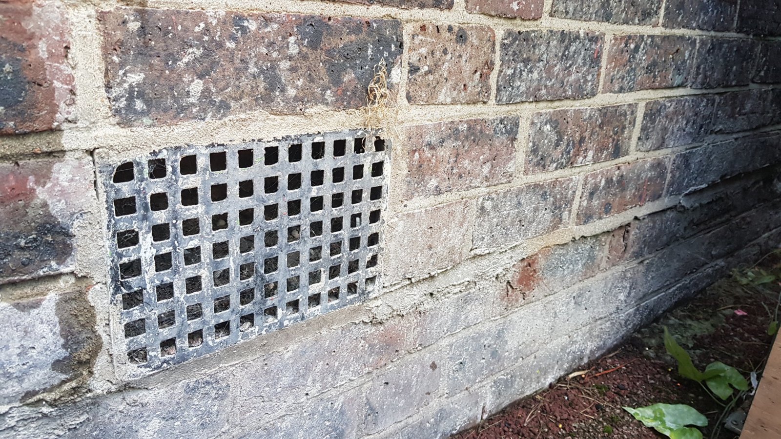

HI,
Is it best to match the height of the existing DPC with the new DPC of the extension?
From the picture would you say the dpc is just below the air bricks? Why are the airbricks above the DPC?
You put the DPC at the new floor level, regardless of where the existing one is.
If that's a timber floor, the DPC is below the floor level.
