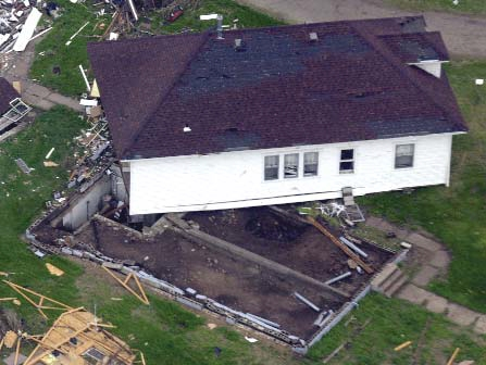

Couldn't you just heave on the brick structure above the DPC and slide it off?

One or 2 courses of a short wall? Maybe.
A full house? Overcoming the friction and inertia generated by 100s of tonnes of bricks would be pretty tricky

Yes 100 tonnes vertical, but horizontally the upper structure has little resistance, like with Earthquakes.

Here you go ..
It demonstrates all three laws.
Well, as with (almost) all physical objects, it obeys all 3 laws, it primarily depicts the conservation of momentum. Whilst it does demonstrate the other 2, it is a particularly poor demonstration of the 2nd
