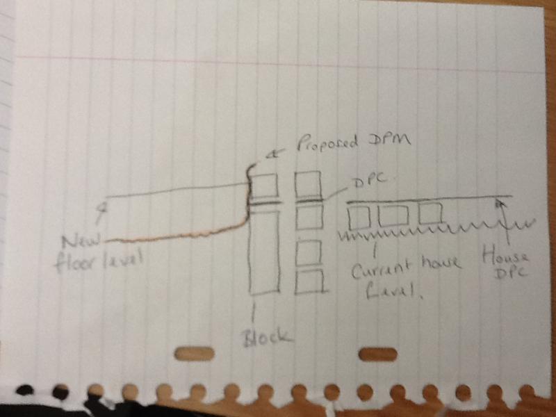

I am installing a full length glass conservatory with four course of brick (2 showing) below. However due to a height issue the new concrete slab floor will 2/3rds the way up the final brick and past the DPC. The only way i can see round this is to install a DPM which goes past the last brick and be tacked in someway. It does have to be at this height so i am a little stuck!
How does this stand or any alternative methods?
The final brick will have approx 1 inch showing above new poor level and the dpc will be approx 1-2 inches below floor level. Diagram to follow!
Your proposal is ok, but why can't you get the connie floor the same level as the existing house floor? :confused:
Thanks for response. It will actually make it level to existing kitchen floor which is two/three inches above dpc
