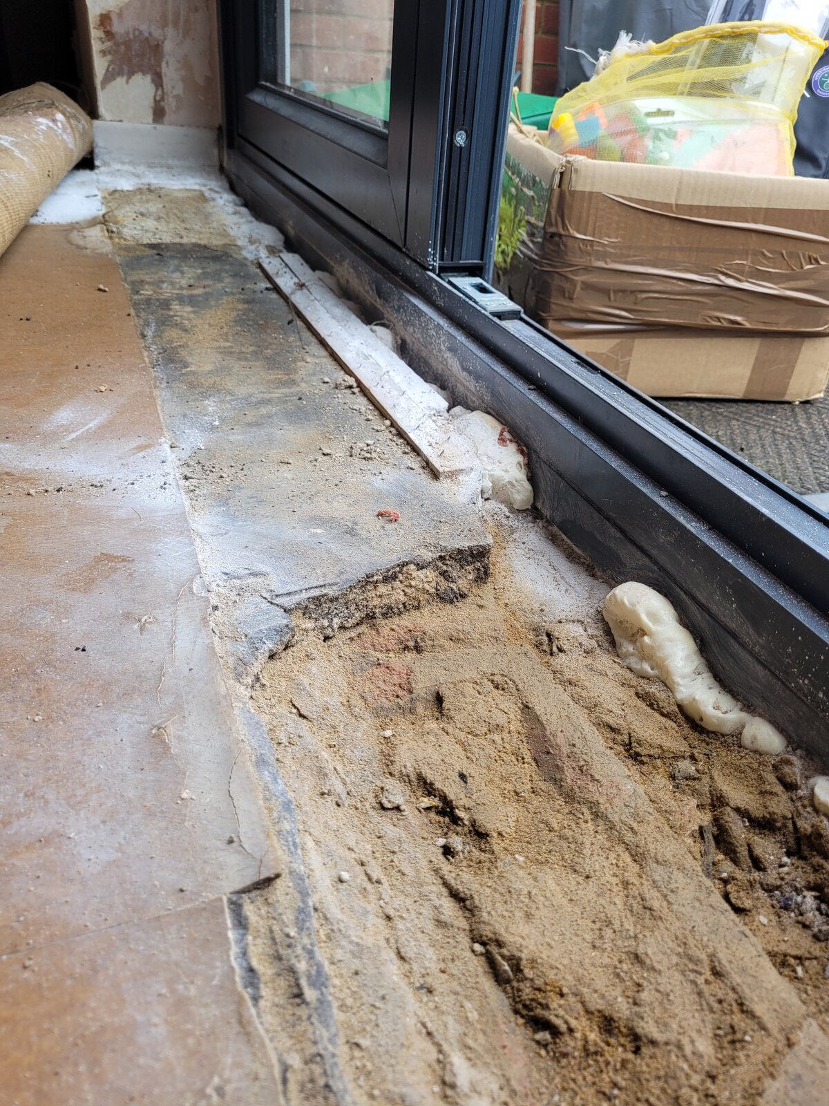

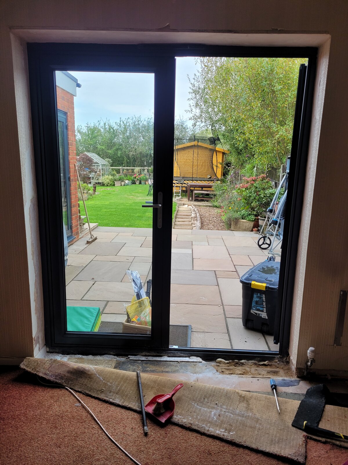

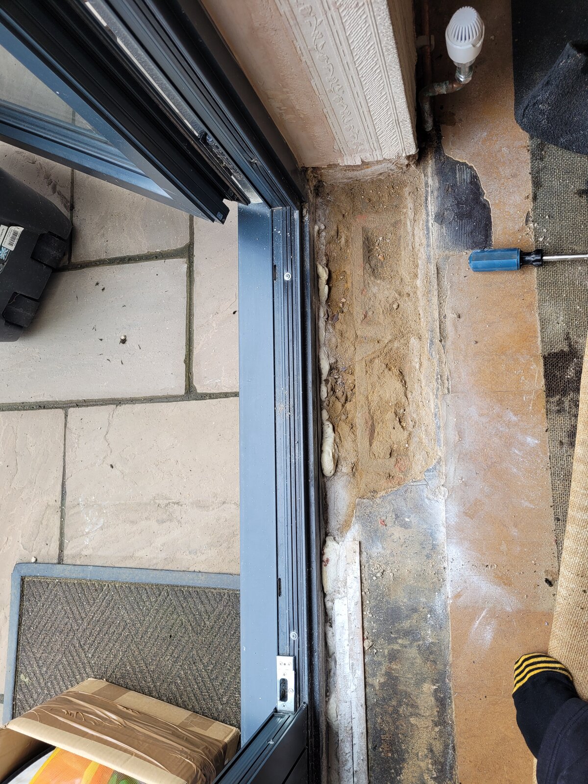

Finally gotten around to doing the living room in the new gaff. It looks like the French doors were made by widening a single door. I pulled away damp and crumbling concrete from the floor with my hand until I got to brick. There's no sign of the slate DPC which is present in the centre (and is used throughout this 50s ex council semi).
Question is what to do to fill the trench? Is there a "damp proof" concrete mix I could chuck in there or would I need to put down a bit of DPM and concrete on top? A bit worried about the shallowness of the concrete over the brick and also when to stop digging out the cavity.
All help gladly received.

I had similar floor. I dug out. Linned with thick rubble sacks and filled with concrete.
I just bought broken bags that seem to always be sold for a £1 ish in my local DIY and mixed up concrete in some tubs and poured in. 6 to 1 ratio of stone and sand, with 1 cement

Did you send a piece of tile or a piece of the backing adhesive? The fibres are generally in the backing adhesive.
There are liquid surface DPMs. Ball Stopgap F77 is one, RIW or any bitumen based product are others.
You may be better off lifting the screed and that course of bricks and insulating the threshold and laying a deeper screed.
So a strip of celotex along the edge of the door, a 1200 DPM in the trench and fill with a standard 6:1 mix?
