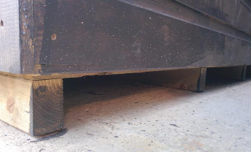

Hi all
I have a new and empty 10x8 shed - built and sitting on a concrete slab as of last weekend. After yesterdays deluge of rain I'm kicking myself for not putting some damp proofing down prior to building.
I'm considering running some 100mm DPC (the roll type) down under the bearers but I have to get the shed lifted ... and then lay the membrane down in such a way that it won't shift when I move the shed into the right position.

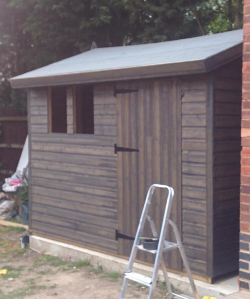

The shed is tanalised and I am planning to weather protect it this weekend with osmo oil / stain so am I going overboard in trying to run a DPC under the bearers?
What do you think guys? also - any tips on how best to lift it up - I'm thinking I may be able to get a car jack below along with bricks to prop up.
Cheers for any advice!
Pic below showing water penetration (though it looks like this is not damp on the inside as far as I could tell)
First of all that watermark will more likely be as a result of the rain water dripping off the roof and either hitting the bottom of the shed on the way down, or splashing up on to it from the ground. This will be why the inside of the shed is unaffected and why the watermark extends up the door which isn't actually part of the structure in contact with the ground. A gutter and downpipe will prevent this happening.

If you put a damp-proof membrane under the timbers, it will be too thin to raise them out of any puddles that may form, so any water that does run under the shed will sit on top of the membrane and the only way it can go is up and into the shed, so it may make the situation worse. The only way to avoid it completely would be to lift the shed on concrete blocks or tiles so that the base timbers were high enough to be clear of any sitting water.

WHile it's empty & without glass - a car jack & some planks will enable you to lift corners (in fact just a wump of wood may do) and then brick it up.
But I'd roll it and wrap the DPC around the bottom and staple it.

Seems like getting some mini guttering is a sensible route - that may end up being all I need to ensure water stays off the concrete slab / prevents splash back

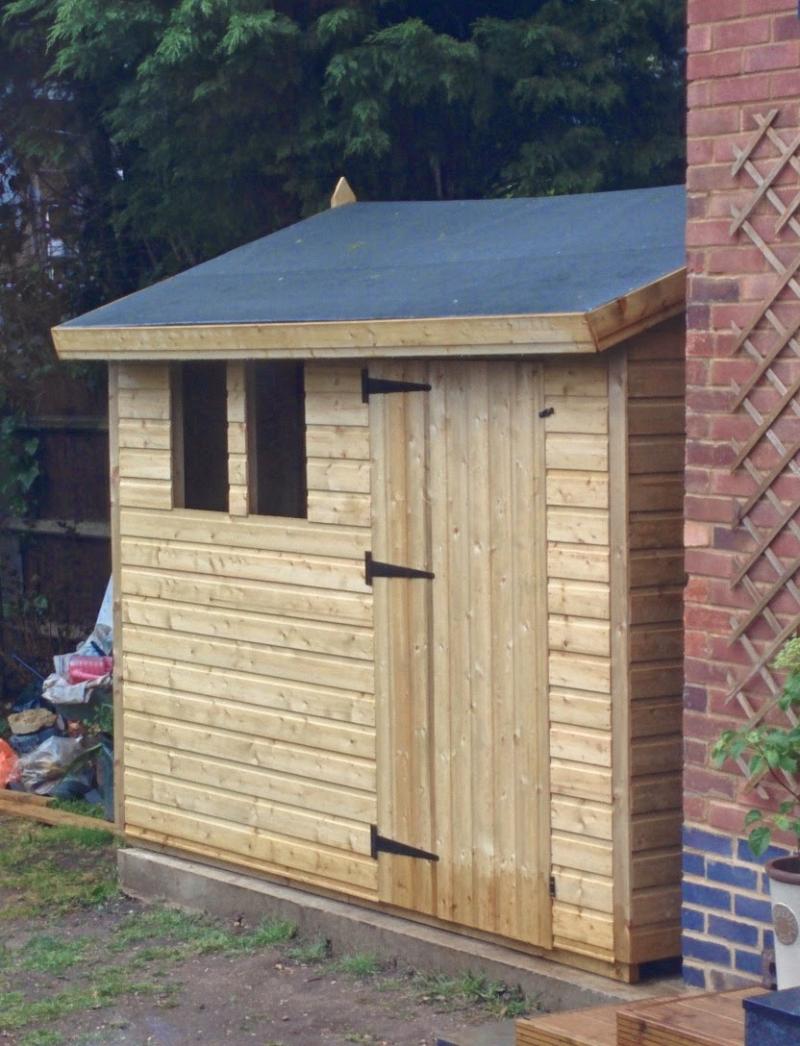

However - the slab base is much larger than the shed - I've just not managed to put it into the final position hence it looks like it is overhanging.
So I may yet try to get a dpc roll lined down below the bearers ... but stapling these up so they don't collect water will be very tricky as I don't think I can raise the shed high enough for me to crawl under and do it that way - unless we are talking about laying dpc just on the bearers that are on the outside?
I'm wondering now if I should just pick up some cheapo flat concrete slabs from B&Q or somewhere and have the shed timber bearers sitting on these ... That in itself will be interesting as I'll need to somehow position the ones that sit in the middle of the shed itself! ... How many slabs would you recommend in this scenario - can I put them in a checkerboard fashion or would I need enough to cover the whole of the base?
