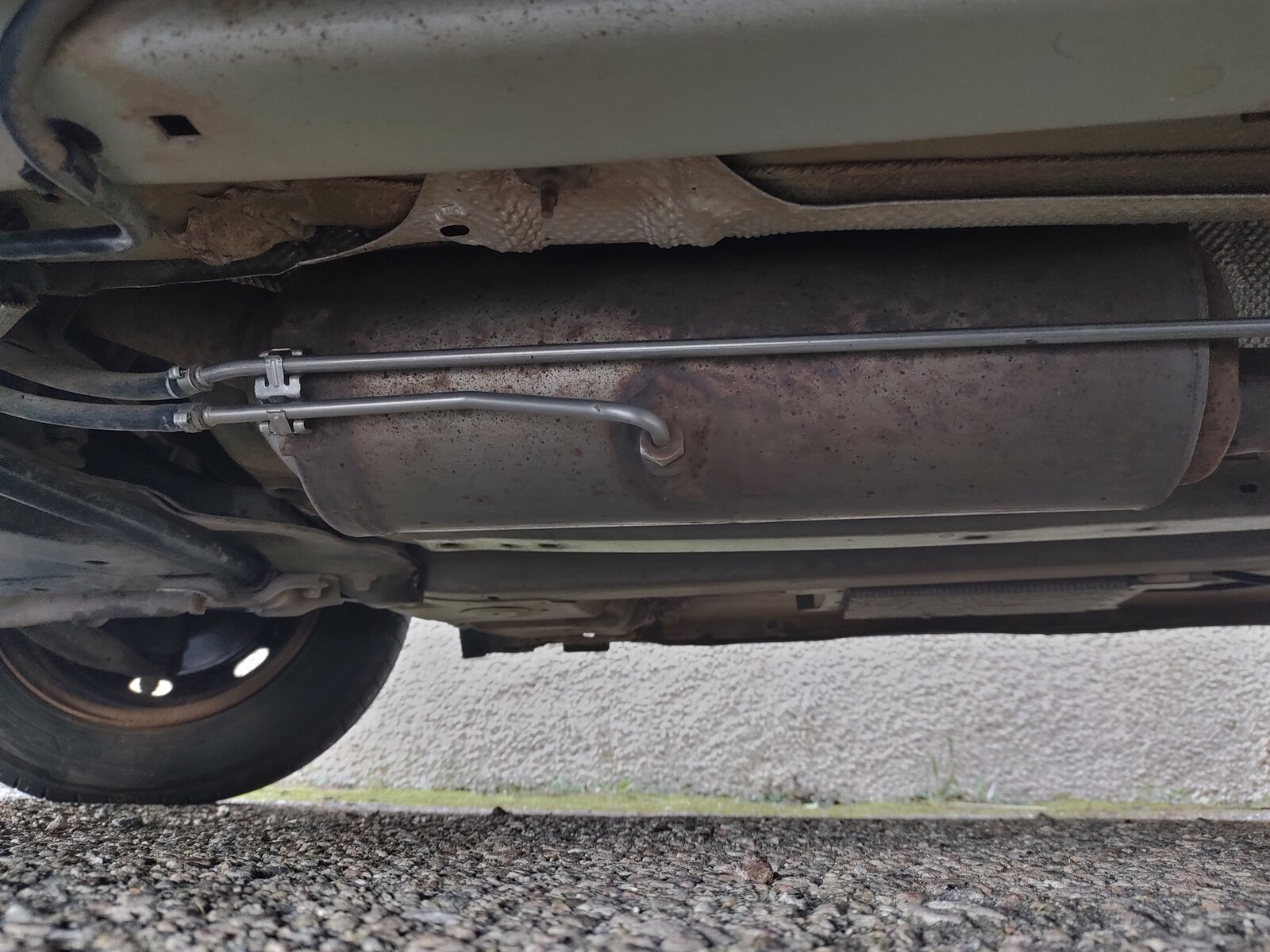

Hi looking for some advice on dpf clean, this is a Peugeot partner 2018 that I just purchased, a warning light has came up for dpf and needs cleaned, looking to do it myself with a can of dpf cleaner, all I need is someone to confirm the location in the picture is where I unscrew and insert the cleaning solution..this is a view from the passenger side, wouldn't let me upload a video..thanks in advance.

DPF cleaners are added to the diesel fuel tank. They work by lowering the temperature at which the soot can burn off - or raising the temperature of the DPF.
A stop gap treatment. I'd wager.

Just thought it might do a better job with getting the cleaner straight Into the filter..can anyone confirm where I think it is.

Unlikely to work
Even professional cleans rarely work well or for long.
If you insist on it being cleaned, remove it and get a full deep clean with a guarantee.
Genuinely otherwise you are just wasting your time and money

So I took it to a garage, they forced a regen and it worked...for about 1mile, lights came back on and went into limp mode, now talking about cleaning the dpf with a can of dpf cleaner and take it from there, if anyone has any other suggestions?
Was still considering cleaning it myself but need to know where it's located to spray the cleaning solution into, I've been told that it's at the front, cat converter/dpf, located sensor, unplug and remove nut to put tube in n and spray dpf spray foam, leave yo soak and take for a drive next day..
Only my opinion but I think the only successful way is to have the dpf removed from the car and professionally washed.....this is done under pressure and in both directions.
A professional firm will check the back pressure after cleaning and drying and then install it back on the car.

So do you think I might be better if getting a deep clean as opposed to spraying a can of foam dpf cleaner into it..
I thought it would be Adblue, looking at the pipes into the dpf.
Adblue is injected as and when the car requires it - we have no control of that. If the Adblue level gets low, it will inform you on the dash and then you have 1500 miles before the engine will refuse to start.
I would have the dpf removed and professionally cleaned.....interfering with an Adblue system may open another can of worms.
