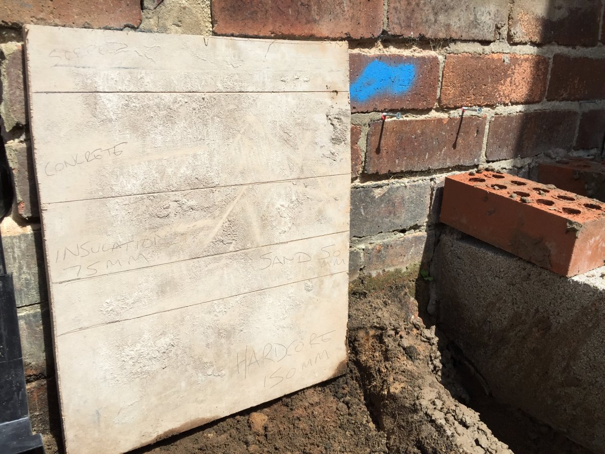

Hi all,
I'm doing the groundworks for my rear single story extension and just trying to get my head around the oversite preparation.
I've measured down from the existing floor level allowing for 150mm hardcore, 50mm sand, 75mm insulation, 100mm concrete and 60mm screed. When I do this, the finished floor is 2 brick course above DPC level. This means that the DPM is level with the DPC so am I right in thinking that I will then have to build another course of block up for the 100mm concrete slab? A lot of the images I've seen online seem to show the concrete layer being level with the DPC and using it to level off but if I did this, I'd be 150mm lower than the existing floor level.
Any advice would be greatly appreciated!

So in the picture the top of the board is the finished floor level
On the right is a brick to show the line of the DPC matched against the same height of the old houses DPC

The finished floor height is the height of the DPC - not below or above it. If you are just concreting then it's level with the concrete, if you are screeding, then it's at that height.
Work out the finished floor height, and gauge the brickwork down from that.
Thanks woody it's the height of the existing DPC that's confusing me so I just need to forget that and work on the new levels. Thanks for your patience
You just need to run your new DPC up or down the wall where the new extenion meets the existing house, and then overlap it with the existing DPC by chopping into the joint.
