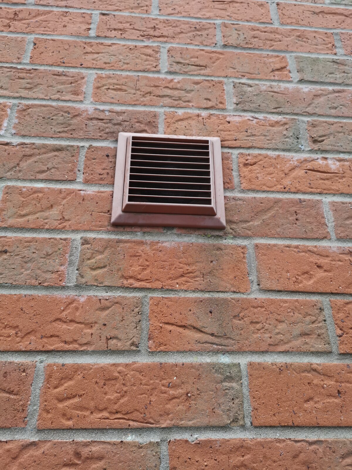

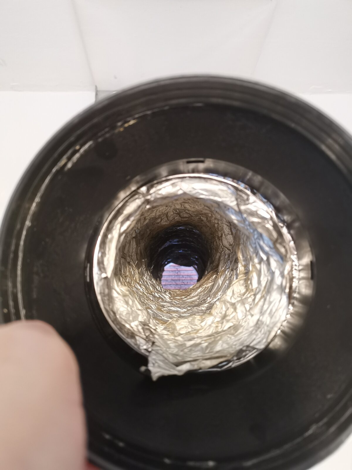

Recently took the extractor hood and splashback down to replaced and noticed especially over the last few days thanks to storm eunice.
You can see straight outside (n) no wonder the kitchens always felt cold,and never seems to hold the heat.
Any advice on what vent I should get for the outside wall? And do I need something inside the pipe that let's the air out but not in?
cowl vent
it is shaped to throw off rain and deflect wind
it includes a one-way flap
will also keep out nesting birds
and pull out that horrible flexi and fit a rigid duct. modern extractors are usually 125mm (old ones were 100mm) If possible, provide a slight tilt so that any condensation runs outside. if it is a cavity wall, you can pack the hole with insulation. Loft mineral wool is fine.
modern cooker extractors and hoods commonly have the extract port on the top. You can fit an elbow.

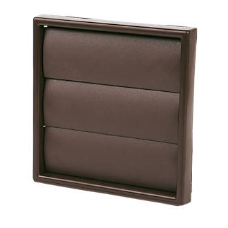

What's the difference between the cowl vent and this? MANROSE FLAP VENT BROWN
Just thinking it would blend in with the outside wall a bit better more flush.
it flaps and rattles in the wind
until the little flaps break off
