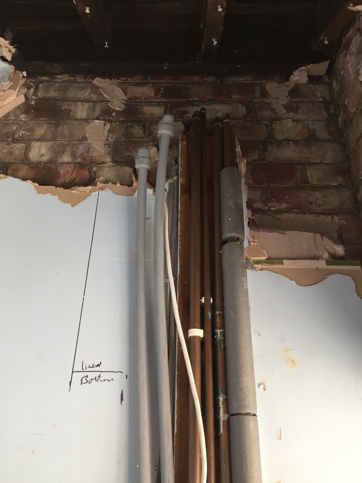

I need to move one of the 22mm pipes feeding the UFH manifold. Extension means i need a little more space where this pipe is currently so moving it 10cm to the right.
This means i need to drain down. The 22mm pipe comes down from the boiler and so water in this pipe is separate from the rest of the boiler radiator system due to the automatic gate valves under the boiler for the UFH.
So the whole system doesn't need a drain down just the UFH section.
I haven't drained down this before so wondered if i just open up the drain valve on the manifold and that is it, or do i do something else ?
Do i need to be worried about air entering the UFH system as well ?

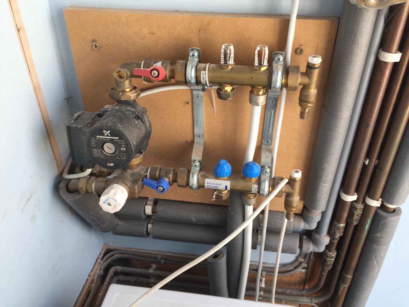

I have taken a photo of the manifold and the 22mm pipe higher up which i want to move to the right a bit more.

There are two radiator type air vents on the right hand side above the drain cocks and you can also vent from the pump bleed screw.
