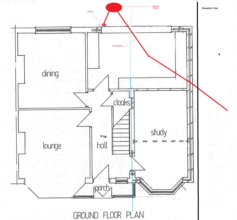

Just looking for some advice, just started digging the foundations for a new extension and come across some drainage issues.
I though that we had a direct access to the main sewer however it appears as though our pipe goes into neighbours garden before connecting into a man hole on their property.
Just wondering how i can connect my new drains which will be in the top right of the drawing attached, my intial plan was to route round the side of the new extension before connecting up with the main drain at the front of the house
Either route the drain round the building if space allows or run it under the new build, taking appropriate measures to protect the pipework.
Bear in mind Building Control may not allow a connection to the sewer for rainwater (assuming you already have a combined drainage system), soakway or surface water drains have to be considered, with connection to foul sewer as a last resort.

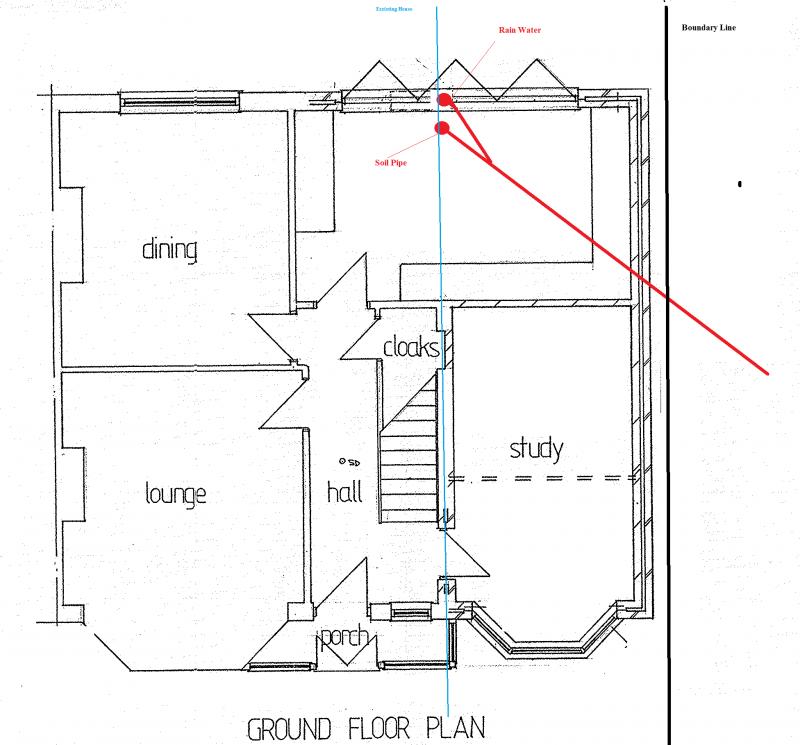

Building inspector came out and has advised the below. Only issue is that the soil pipe into the inspection chamber will be quite steap.
We got lucky as rainwater and waste can be put into the sewer drain, and there is a exsisting pipe going to a garage in the back garden that we are able to break into.
Why will the soil pipe into the chamber be steep? Site the rest bend at the foot of the stack at the correct invert to achieve sensible fall on the run to the chamber.
With that layout you are looking at a 90 deg turn using the chamber, if the fall is too steep you run the risk of the discharge entering the chamber at highspeed and fouling the benching on the opposite side. This could build up leading to future issues with blockages. :(
