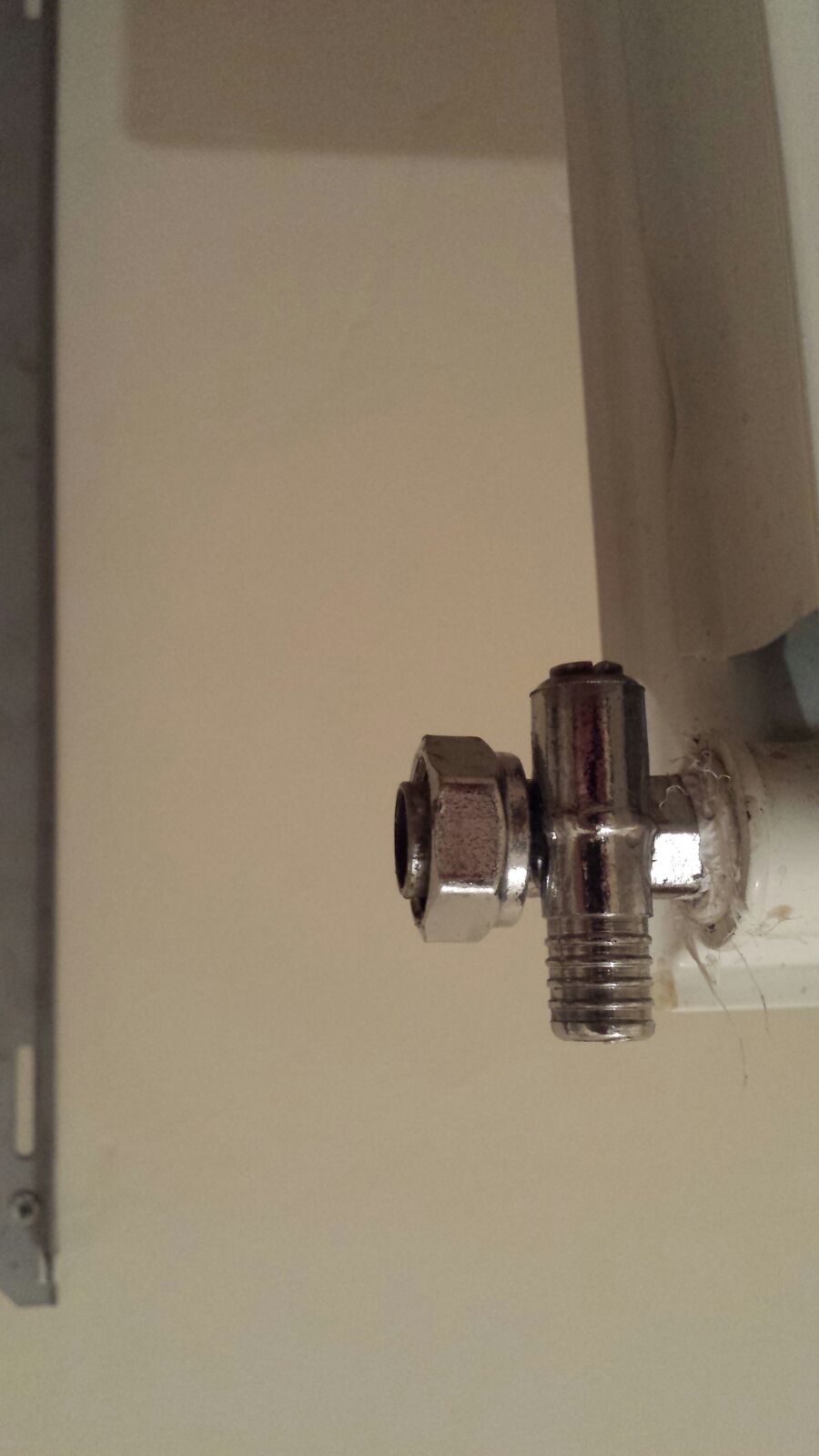

Hi
We have removed the radiator and when placing it back on the wall the drain off valve is leaking.
We have turned the screw clockwise but may have damaged the washer?!?!
Not sure what to do and can't see how to change the washer.... Help
These type of drain-offs can be a right pain.
As a temp fix you could wrap PTFE tape around the thread of the stopper screw.
If you completely unscrew the stopper, that should then give you access to any washers/seals.
